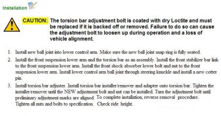

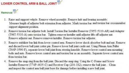

How do I remove lower ball joint
Do I have to remove front axle?
