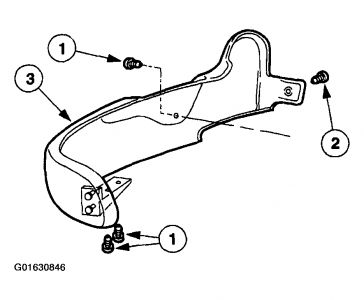

THE SEAT DEVELOPED A HOT SPOT IN IT AND THEN A FEW DAYS LATER QUIT WORKINGALTOGETHER. THE INDICATOR LIGHT STILL WORKS SO I BELIEVE IT HAS POWER. NOT A FUSE ISSUE. I BELIEVE THE PAD HAS SIMPLY "BURNED OUT". I HAVE ORDERED A GENERIC REPAIR KIT THAT REPLACES THE SEAT AND BACK PADS AND WIRING FOR $69. ANY HELP ON HOW TO REMOVE THE SIDE OF THE SEAT (PLASTIC) AND SEAT COVER WOULD BE APPRECIATED.

Do you have the full bench seat... Or the 60/40 or with integrated restraitnts...

Yea 60/40 split bench. Just driver seat not working

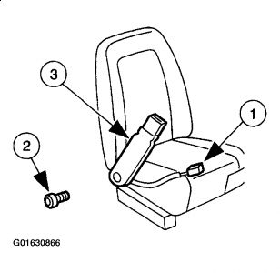

IMPALASS
  • 3,112 POSTS
Hello -
I gave you the info for both 60 and 40.
FRONT SEAT - 60 PERCENT
Removal
NOTE: Removing the 60 percent front bench requires more than one technician.
1. Remove the 60 percent front bench.
1. Remove the seat riser bolts and the safety belt bolt.
2. Remove the nut.
3. Disconnect the electrical connectors (if equipped) and remove the seat.

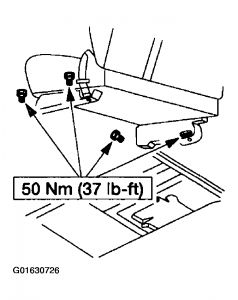

1. Remove the two front bolts.
Fig. 119: Removing Two Front Bolts
Courtesy of FORD MOTOR CO.
https://www.2carpros.com/forum/automotive_pictures/248015_119_1.jpg

1. Remove the rear bolts.
2. If equipped, disconnect the seat control switch electrical connector.
3. Disconnect the safety belt warning indicator electrical connector.
4. Remove the front seat.
Fig. 120: Removing Two Rear Bolts
https://www.2carpros.com/forum/automotive_pictures/248015_120_1.jpg

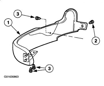

4. Remove the front seat track side shield (62187).
1. Remove the screws.
2. Remove the pin-type retainer.
3. Disconnect the electrical connectors (if equipped) and remove the front seat track side shield.
Fig. 238: Removing Front Seat Track Side Shield
https://www.2carpros.com/forum/automotive_pictures/248015_238_1.jpg

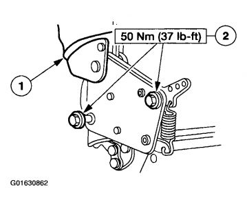

NOTE: Do not damage the plastic pivot bushing when removing the front seat back frame.
5. Remove the front seat back frame.
1. Remove the bolts.
2. Pull the front seat back frame away from the inboard front seat hinge and remove the front seat back frame.
Fig. 239: Removing Front Seat Back Frame
https://www.2carpros.com/forum/automotive_pictures/248015_239_1.jpg

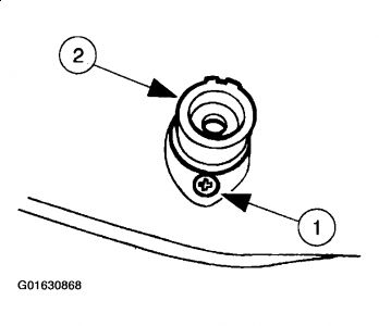

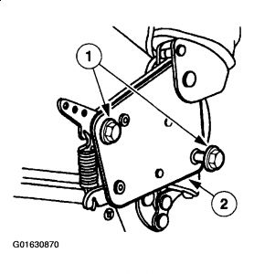

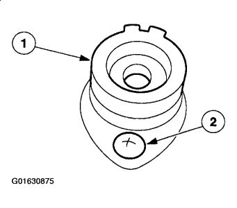

https://www.2carpros.com/forum/automotive_pictures/248015_260_1.jpg

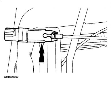

NOTE: The lumbar support assembly must be fully relaxed.
5. Fig. 261: Identifying Lumbar Support Adjuster
https://www.2carpros.com/forum/automotive_pictures/248015_261_1.jpg
6. Separate the lumbar support adjuster from the adjuster cable.
7. Disconnect the front seat back recliner from the front seat cushion frame (63101).
2. Disconnect the front seat back recliner (62187).
Fig. 262: Disconnecting Front Seat Back Recliner From Front Seat Cushion Frame

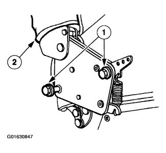

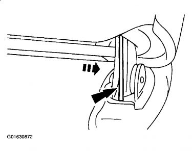

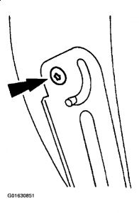

NOTE: Do not damage the plastic pivot bushing when removing the seat back frame.
8. Pull the front seat back frame away from the inboard front seat hinge.
"Â If equipped, feed the lumbar support cable through the seat cushion opening while removing the front seat back.
Fig. 263: Pulling Front Seat Back Frame Away From Inboard Front Seat Hinge
https://www.2carpros.com/forum/automotive_pictures/248015_263_1.jpg

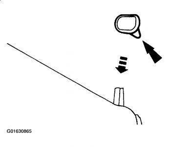

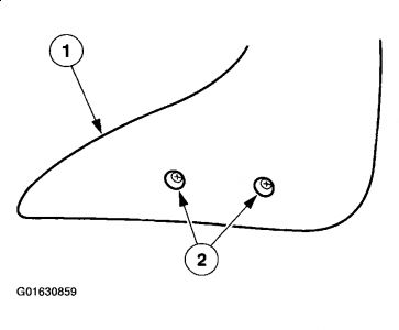

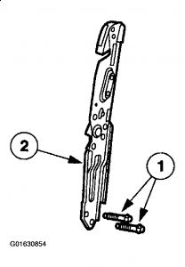

Assembly
NOTE: Inspect the seat back pivot bushing and replace if damaged.
1. Push the seat back frame onto the front seat hinge.
"Â If equipped, feed the lumbar support adjuster cable through the seat cushion.
Fig. 264: Pushing Seat Back Frame Onto Front Seat Hinge
https://www.2carpros.com/forum/automotive_pictures/248015_264_1.jpg

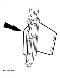

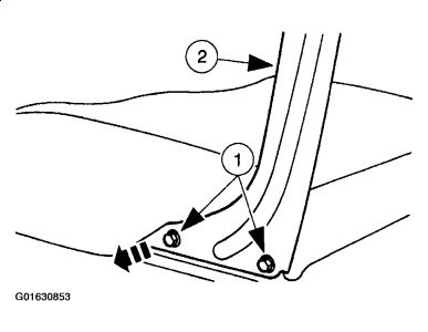

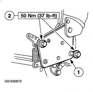

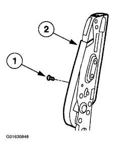

2. Connect the front seat back recliner to the front seat cushion frame.
1. Position the front seat back recliner.
2. Install the bolts.
Fig. 265: Connecting Front Seat Back Recliner To Front Seat Cushion Frame
https://www.2carpros.com/forum/automotive_pictures/248015_265_1.jpg

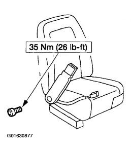

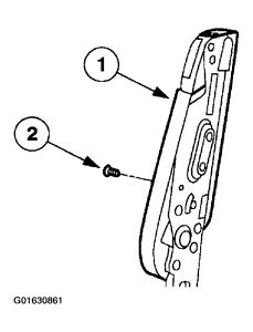

3. Connect the lumbar support adjuster to the adjuster cable.
Fig. 266: Connecting Lumbar Support Adjuster To Adjuster Cable
https://www.2carpros.com/forum/automotive_pictures/248015_266_1.jpg

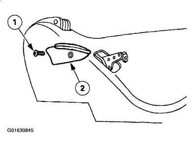

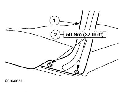

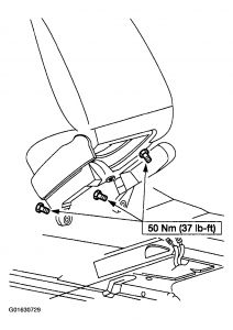

4. Install the lumbar support adjuster.
0. Position the lumbar support adjuster.
1. Install the two screws.
Fig. 267: Installing Lumbar Support Adjuster
https://www.2carpros.com/forum/automotive_pictures/248015_267_1.jpg

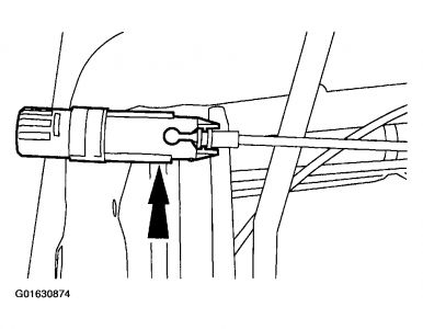

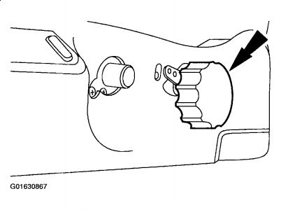

5. Install the lumbar support adjuster knob.
Fig. 268: Installing Lumbar Support Adjuster Knob
https://www.2carpros.com/forum/automotive_pictures/248015_268_1.jpg

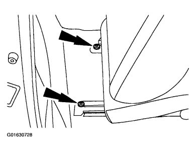

6. Install the safety belt buckle.
0. Install the safety belt buckle.
1. Install the safety belt fastener.
2. Connect the safety belt warning indicator switch electrical connector.
Fig. 269: Installing Safety Belt Buckle
https://www.2carpros.com/forum/automotive_pictures/248015_269_1.jpg
7. Install the front seat track. Refer to SEAT TRACK-MANUAL or SEAT TRACK-POWER.
8. Check the restraint system for correct operation.

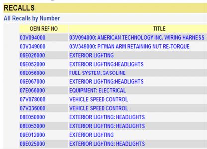

Hello -
Also, it looks like you may have some recalls on your vehicle. The dealer may fix these for free. Please contact the dealer service department, give them the VIN number of your car and have them check on these to see if they apply to you.
https://www.2carpros.com/forum/automotive_pictures/248015_recall_5.jpg
