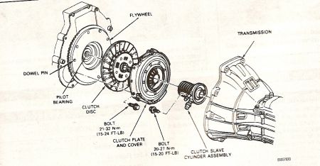

HI guys. I have a 2003 ford f150 4x4 with 5 speed manual trans (mazda trans) and the clutch pedal went to the floor. I checked the fluid and found empty. after filling the fluid back up I found it pouring out of the transmission in between the engine and trans. I traced the lines from the reservoir to the trans and found no leaks there. Have any idea of what let go?

the clutch slave cylinder is on the inside of the bellhousing. That is the probable cause for the problem, see attached
https://images.2carpros.com/forum/automotive_pictures/54223_slv_cyl_1.jpg

Thank, after looking again today I guess your right.
