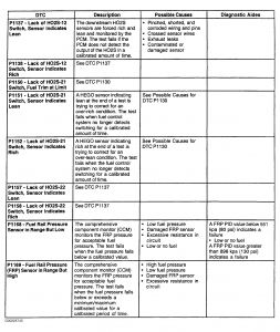

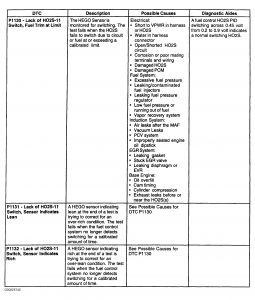

I have a 2003 ford f150 (4.2L EFI) automatic the engine light came on so I had it checked and here are the codes P1157, P1131 but the engine runs fine can you help me.
Nov 19, 2008 at 4:12 AM
DAVE H
  • 13,383 POSTS
both codes refer to the same fault ..H20s 11 switch, fuel trim at limit .. see possible causes on first diagram under code P1130
