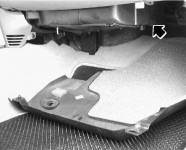

Where is the cabin air filter, and how do I change it?
Apr 28, 2009 at 12:46 PM
  • 55,423 POSTS

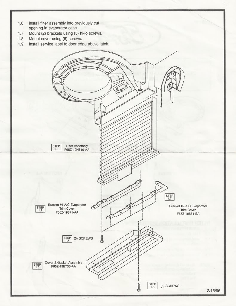

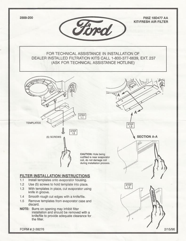

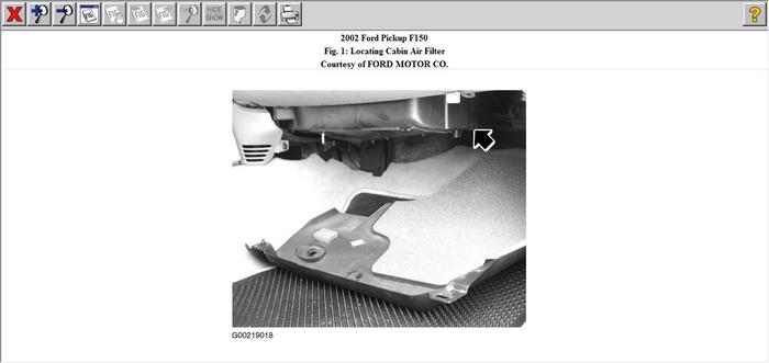

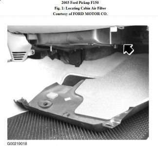

Hey Sharkatac9, Here is a guide and article on how to replace your cabin air filter. Some trucks are not quipped though so don't be surprised if you can find it. Removal and Installation Cabin air filter is available as an optional dealer-installed kit. Cabin air filter installation instructions are included with the kit. If a filter is already installed, it is located under the right side of the instrument panel in the HVAC housing. Trim panel may have to be removed to gain access to filter. See Fig. 1. Fig. 1: Locating Cabin Air Filter
https://images.2carpros.com/forum/automotive_pictures/266999_cab_2.jpg
https://www.2carpros.com/articles/how-to-change-an-air-cabin-filter Please let us know happens so it will help others.

Remove the right hand lower instrument panel insulator. If it has a filter it will be attached there. It was a dealer installed option so it will depend on who ordered the truck if it has one.

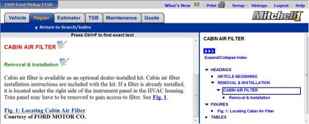

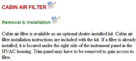

Hello, Im having a hard time replacing my cabin air filter. 2002 F150 Xlt Supercab. To my knowledge it is behind the glove box. I removed the bottom cover, and i'm lost from there. thanks
Apr 19, 2021 at 4:07 AM (Merged)
  • 75,992 POSTS
CABIN AIR FILTER
Removal & Installation

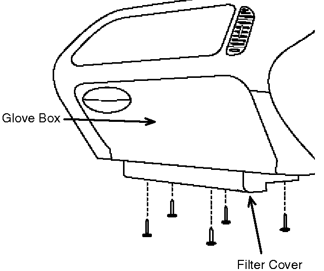

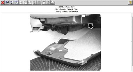

Does the 2001 F150 have an cabin air filter? If so where is it located.
MERLIN2021
  • 17,250 POSTS
Not installed on all vehicles! Optional, can be installed on any F150.
https://images.2carpros.com/forum/automotive_pictures/62217_cab_1.jpg

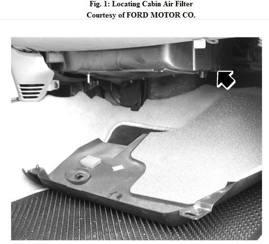

where is it located ?
  • 75,992 POSTS
https://images.2carpros.com/forum/automotive_pictures/12900_cabin_filter_6.jpg
https://images.2carpros.com/forum/automotive_pictures/12900_cabin_filter1_1.jpg

Where is the air cabin filter located on a 1998 Ford f150??
  • 75,992 POSTS
Note: Not all of these vehicles were equipped with a Cabin Air Filter. Only vehicles with a filter cover in the location shown have a Cabin Air Filter

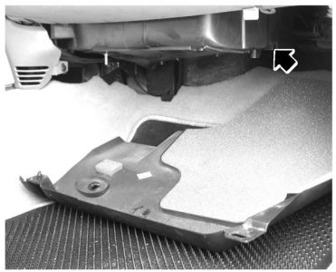

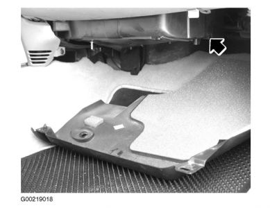

The A/C and heater are working. I can hear the blower. However, there is very little air coming out of the panel. Is this a bad switch [a/c,max,panel, etc] or is there another switch someplace that routes the air? in other words, everything seems to be fine, but little air comes out the vents outward.
Apr 20, 2021 at 2:47 AM (Merged)
2CARPRO JACK
  • 11,533 POSTS
If the blower speeds are aall working and the vents are ok, you may have a cabin filter that is plugged up.It was a dealer installed option on those trucks.Here is a pic of where it is located,(under the dash on pass side)
https://images.2carpros.com/forum/automotive_pictures/1639_ford_8.jpg
