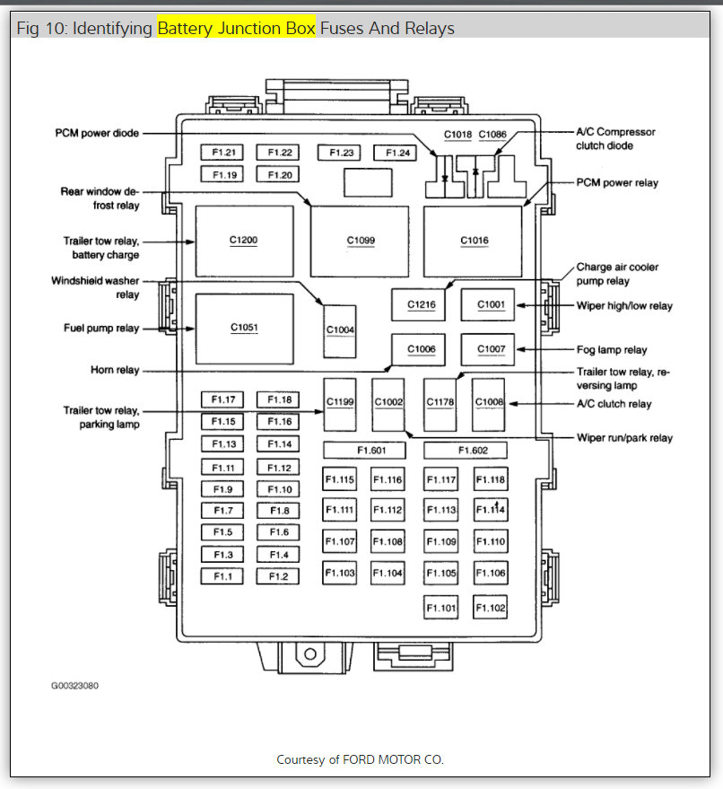

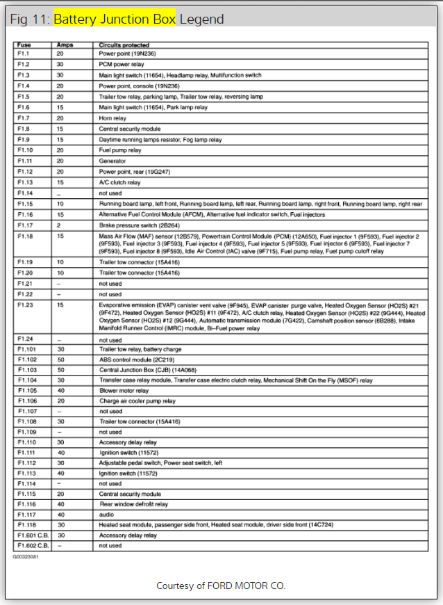

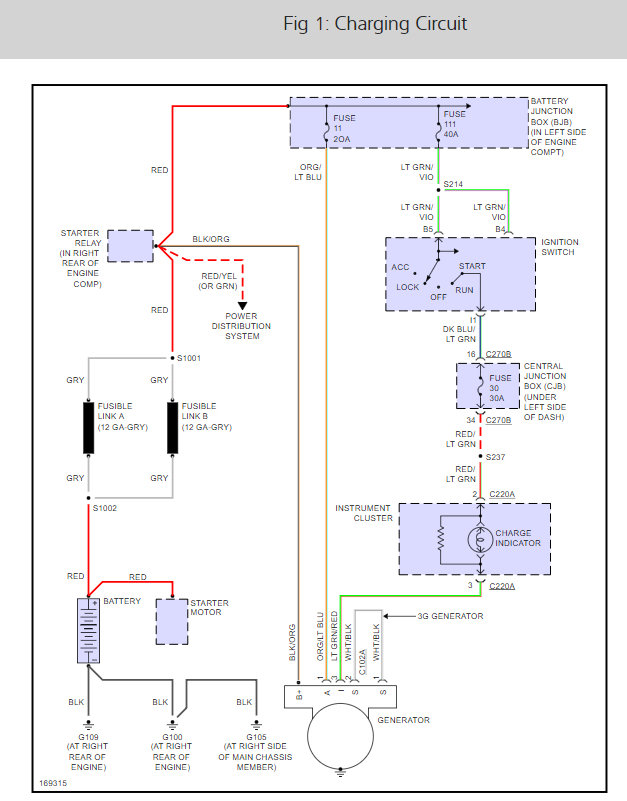

What else would cause the truck not to charge? I replaced battery and 3 alternators and it will not keep a charge. Ive checked voltage while running and not running and it is just using power from battery

There is a fuse #F1.11 that sounds like it is blown or one of the fusible links is shorted here is a guide top help you check for power and the alternator wiring diagrams so you can see what to test.
Check out the diagrams (Below). Please run this test and get back to us.

Thanks for the guide it was the fuse on my truck I love this site.
