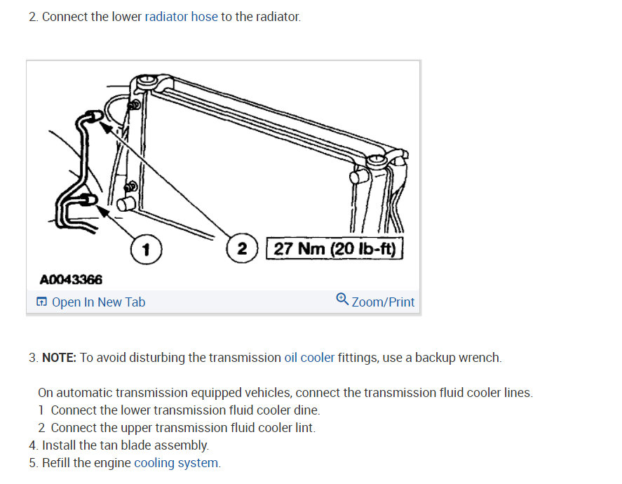

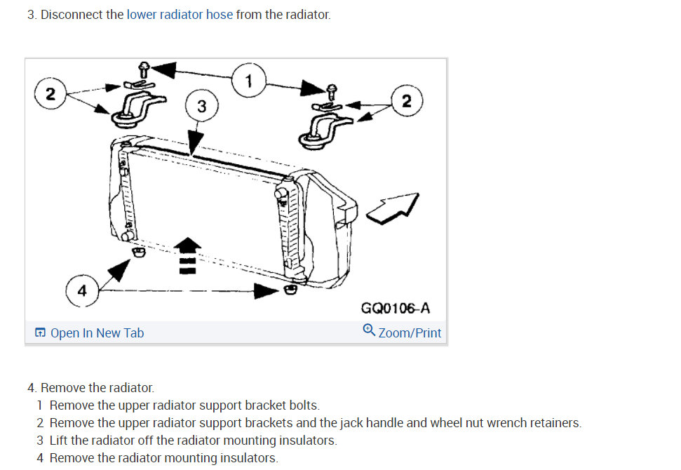

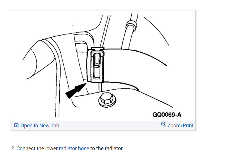

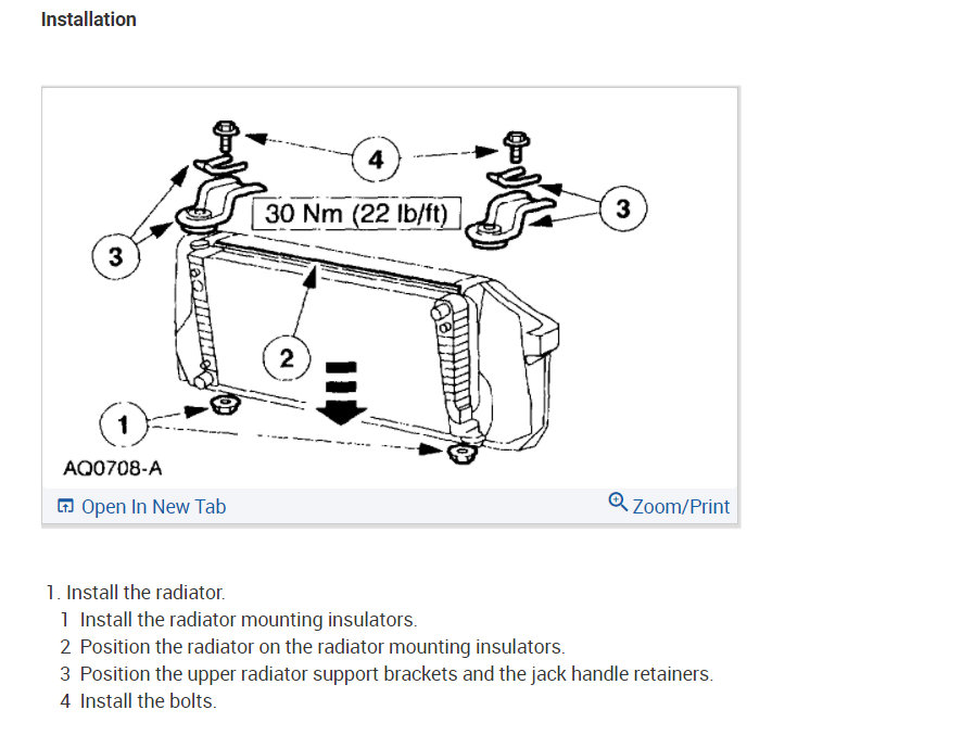

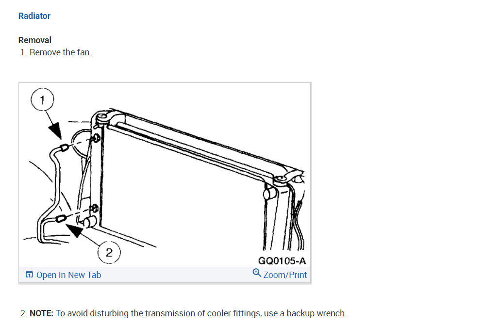

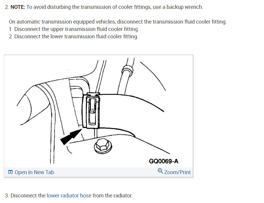

My truck is awesome in that I've never had any serious problems with it. I change oil on a regular basis (about every 3500 to 4000 miles), but with 88,000 miles on it, now it needs a radiator.
Jun 7, 2009 at 7:02 PM
Good evening
I attached the procedure for you below for the repair.
https://www.2carpros.com/articles/how-to-replace-a-car-radiator
https://www.2carpros.com/articles/coolant-flush-and-refill-all-cars
Let us know if you have any other questions.
