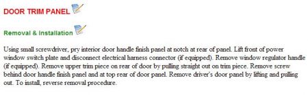

How do you remove the interior front right door panel?
Aug 19, 2009 at 10:49 AM
BLUELIGHTNIN6
  • 16,542 POSTS
https://images.2carpros.com/forum/automotive_pictures/261618_Noname_853.jpg
