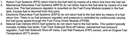

i have a 4.2 v6 f150 and i need to know where exactly the fuel pressure regulator is located because it is not on the driver side fuel rail. so where exactly is it.

What engine does this have? 4.2 has a regulator on the fuel rail...other Ford sixes do not. Here are the differences.
https://images.2carpros.com/forum/automotive_pictures/62217_FuelSytem_4_1.jpg
https://images.2carpros.com/forum/automotive_pictures/62217_FST_1.jpg
