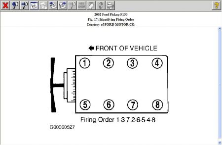

My truck is missing or sputtering at random while driving, I was told to replace my # 2 coil. Where is that coil located? Drivers side,passanger, front or back of engine?

What liter engine do you have?

5.4 liter

See below
https://images.2carpros.com/forum/automotive_pictures/12900_fo_5.jpg
