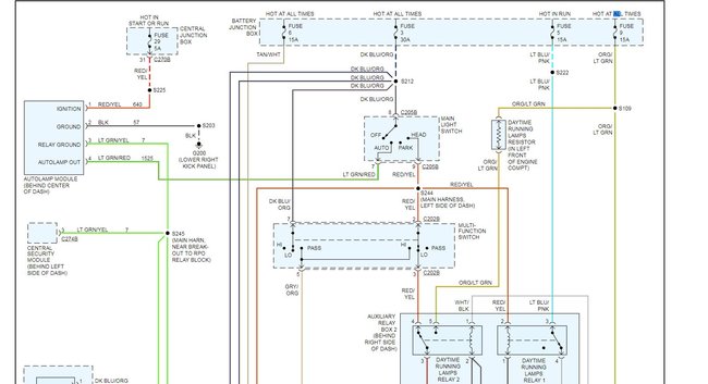

Daytime running lights not working when truck is started.
Jan 1, 2008 at 2:44 PM
BMRFIXIT
  • 19,053 POSTS

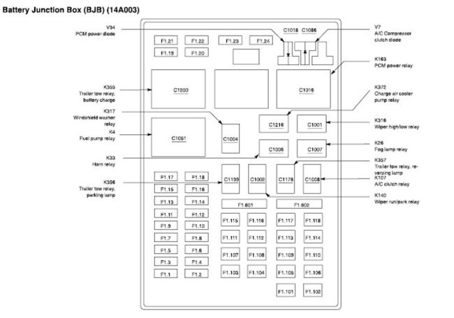

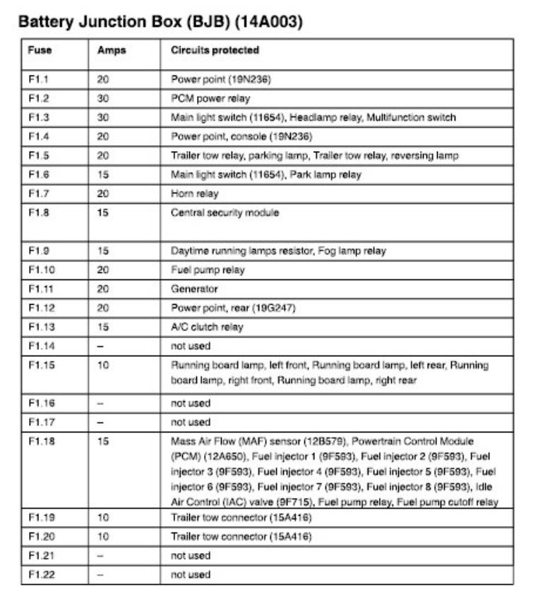

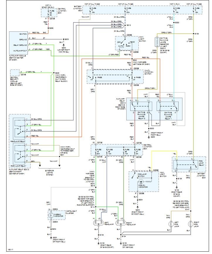

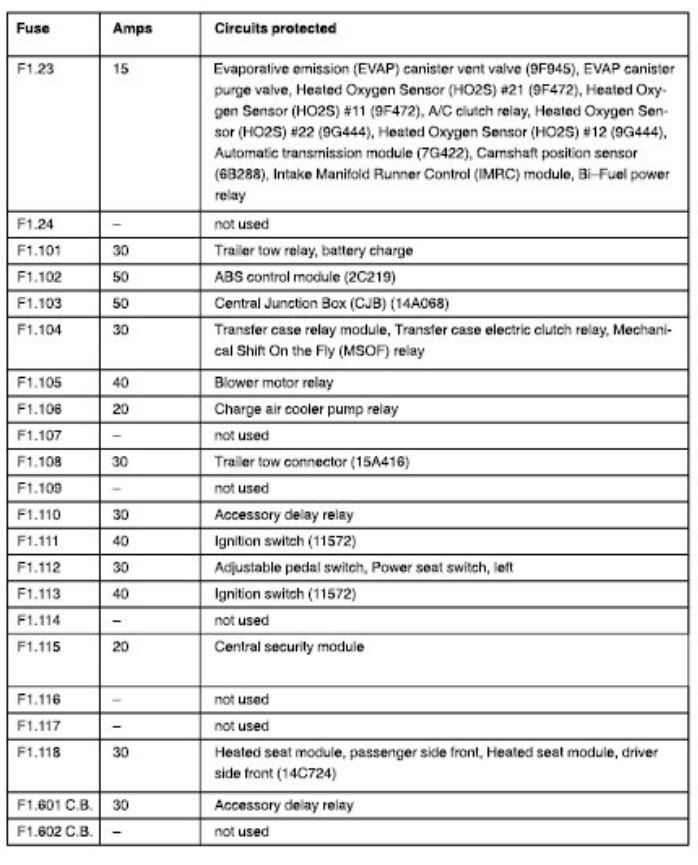

There are a couple fuses and relays that control the DRL's in your truck. Of course start basic and be sure the bulbs are good, after that you will need to do some testing to see what the problem is.
See the attached guides/diagrams below for information on how to test wiring and relays.
Check back in with what you find

My DRL has suddenly stopped working. I have a 2003 Ford F150 XL. The headlights both work and both fuses (in the cab and under the hood) are fine. What else can I check from here. What would cause them to suddenly stop working?
Thank you
Sep 14, 2018 at 6:03 PM (Merged)
  • 75,992 POSTS

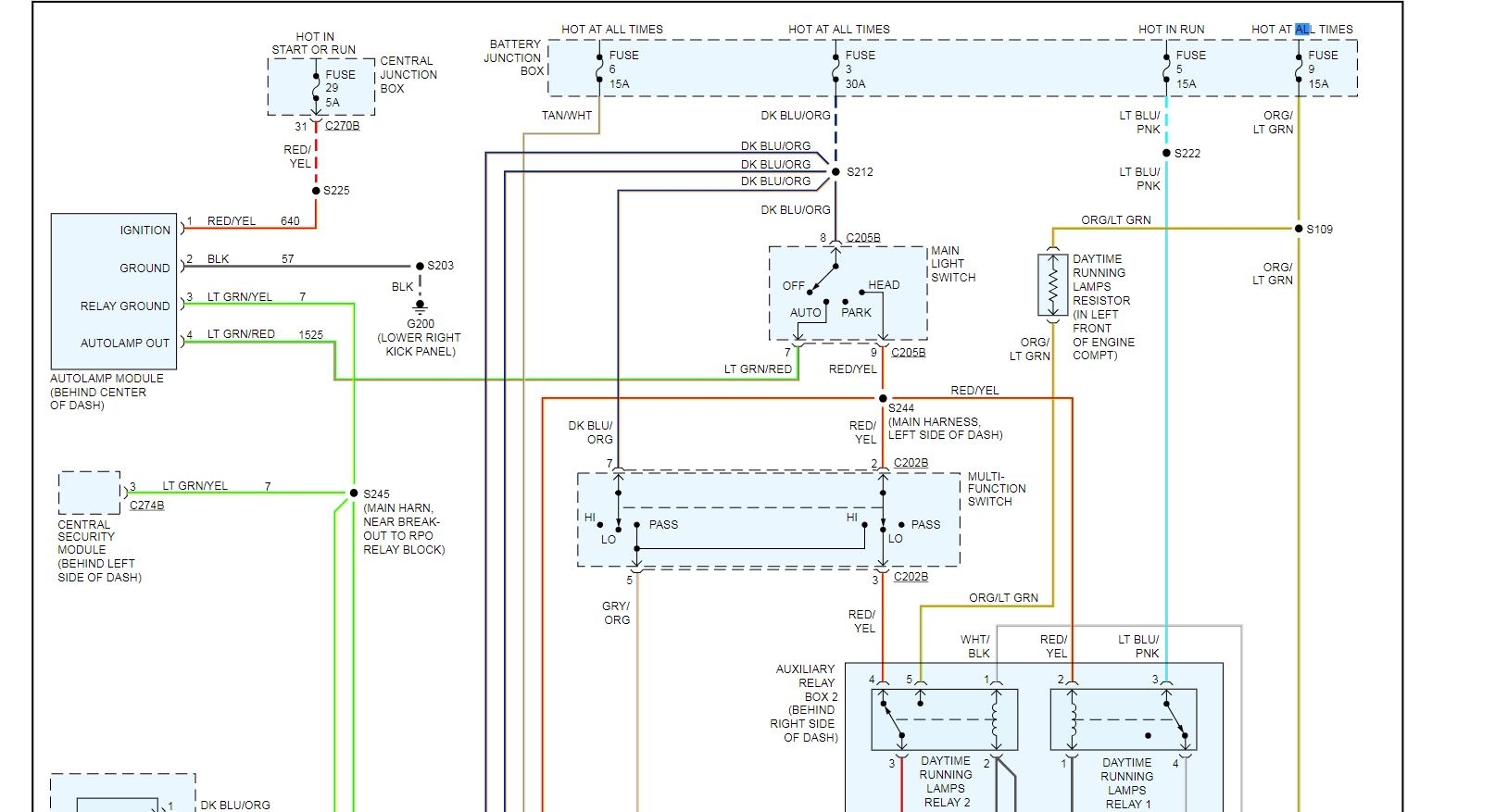

Check the ground at the lower right footwell this is what the relays need to work
JENNY1ST
I checked the ground wire which was broken, so I got a new connector and made it work again. thanks for the tips this site rocks!

Could you describe where the ground wire is more precisely? I don’t exactly know where the lower right footwell is, but I have this same issue.
Mar 9, 2021 at 9:10 PM
  • 110,194 POSTS
The footwell is where your feet would sit. If you were in the passenger side, it would be approximately where your right foot would lean against the kick panel.
Let me know if you find it.
