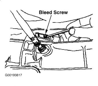

My 2002 Ford F-150 has a leaky slave cylinder. I have been short on cash lately so until I can afford the parts and have the time to pull the transmission, as a bandaid i've just been keeping the master cylinder for clutch full of dot3 brake fluid, and pumping the clutch alot everytime I drive it. This morning when I went to pump the clutch, the pedal sticks to the floor and does not come back to my foot. could I have worn out my clutch cable by pumping it so much? I really have no idea where to start. Please help. thanks alot.

Hi Slave may have given it up so you can try filling and bleeding. see diagram

Is the bleeder screw located on the bellhousing?

Yes right above hydraulic line from master
