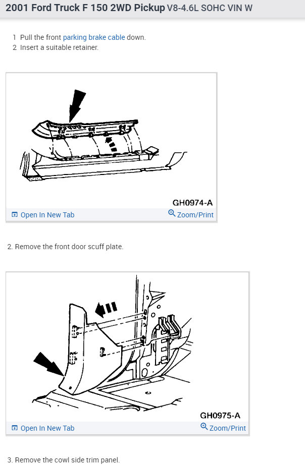

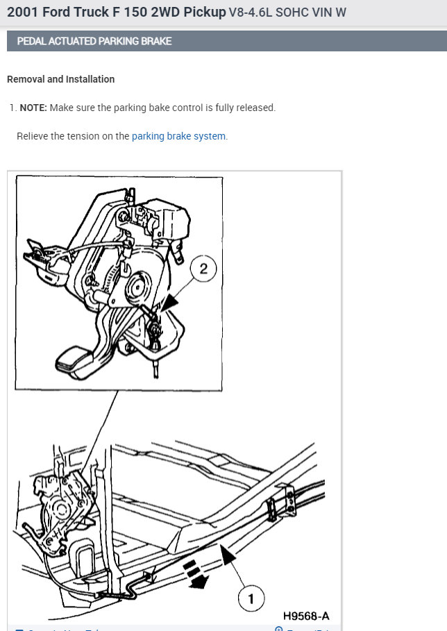

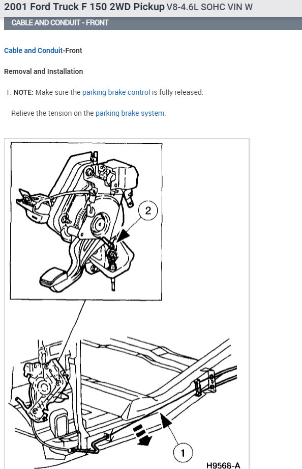

i cant figure out how to tighten it and truck wont pass inspection with out this working better
Sep 7, 2008 at 11:56 PM
SQM
  • 6,383 POSTS
Any time the parking brakes does not engage make sure the brake shoes are in good shape and not worn.
https://www.2carpros.com/articles/parking-brake-shoe-replacement

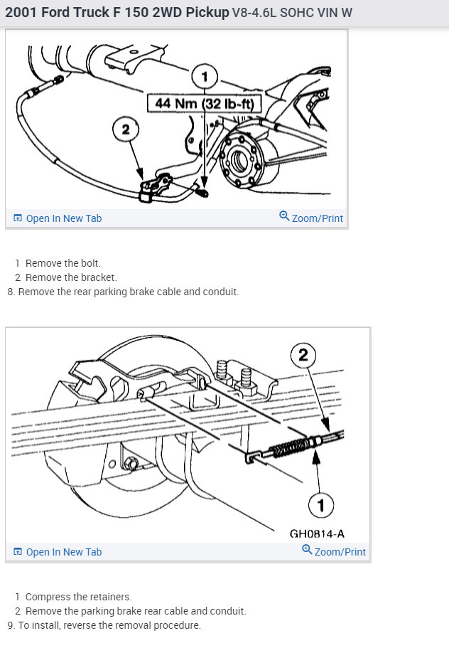

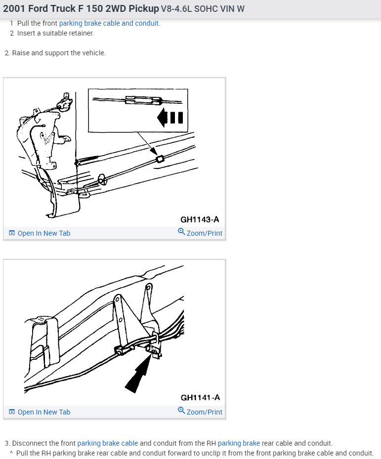

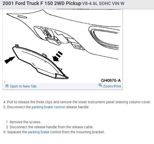

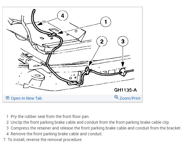

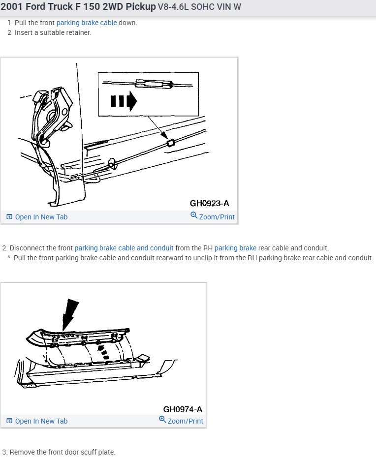

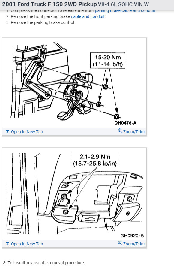

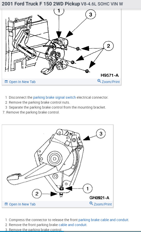

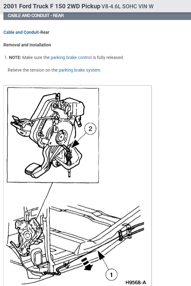

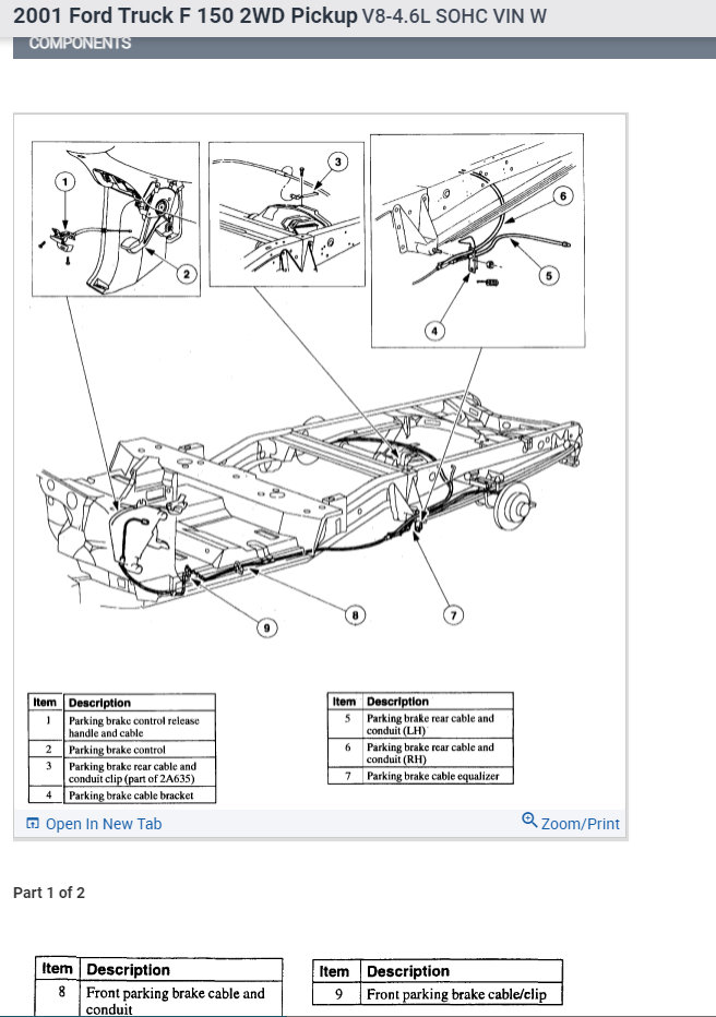

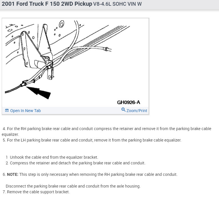

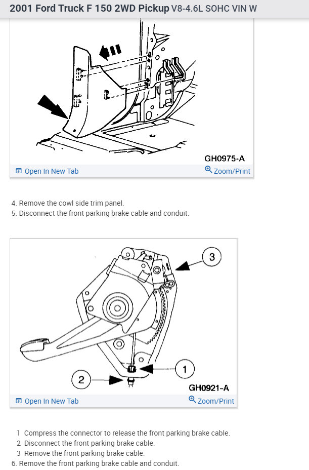

On this truck there is no adjustment for the parking brake cable. If the cables are scratched, then they will need to be replaced.
Do an inspection of all the cables and make sure you don't have a damaged bracket. Also inspect the pedal to make sure it is actuating properly.
I have attached the complete brake cable replacement instructions for your reference.
