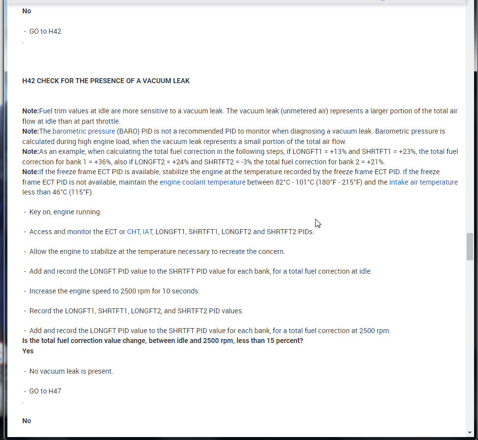

My check engine light came on today and the code reads PO174 System to Lean (bank 2). Was wondering where the maf sensor is located on the 4.2 v6. The truck is a 2001 with 120,000 miles.
Dec 27, 2007 at 4:35 AM

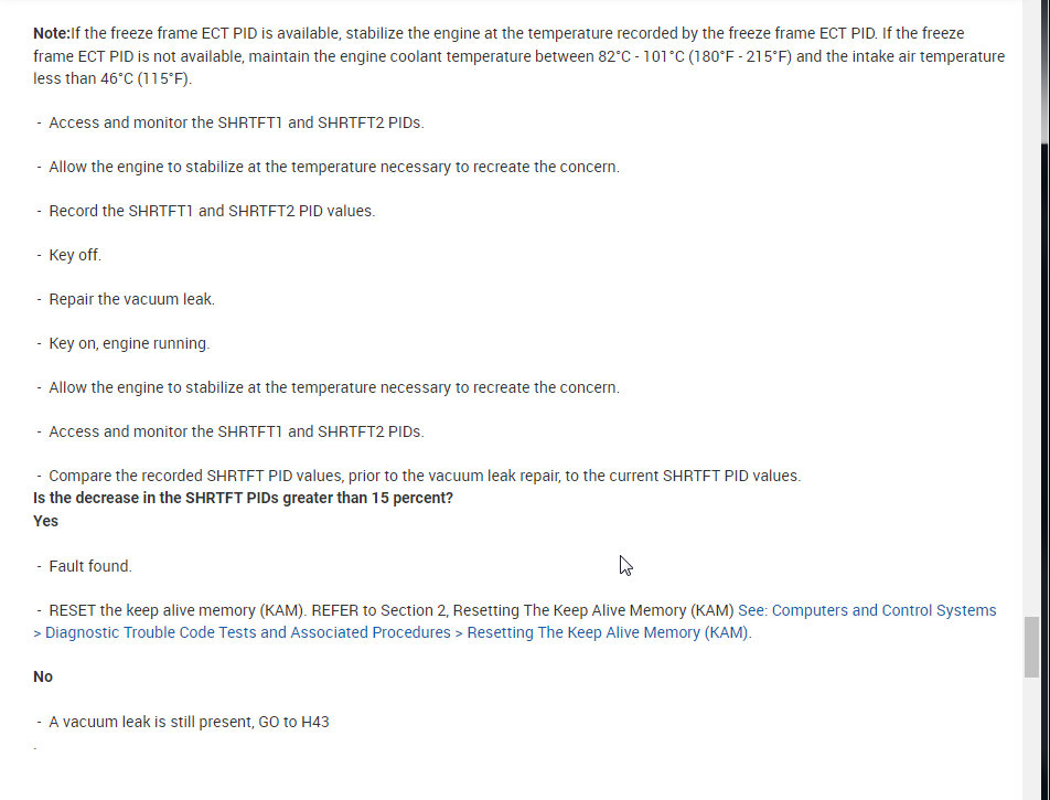

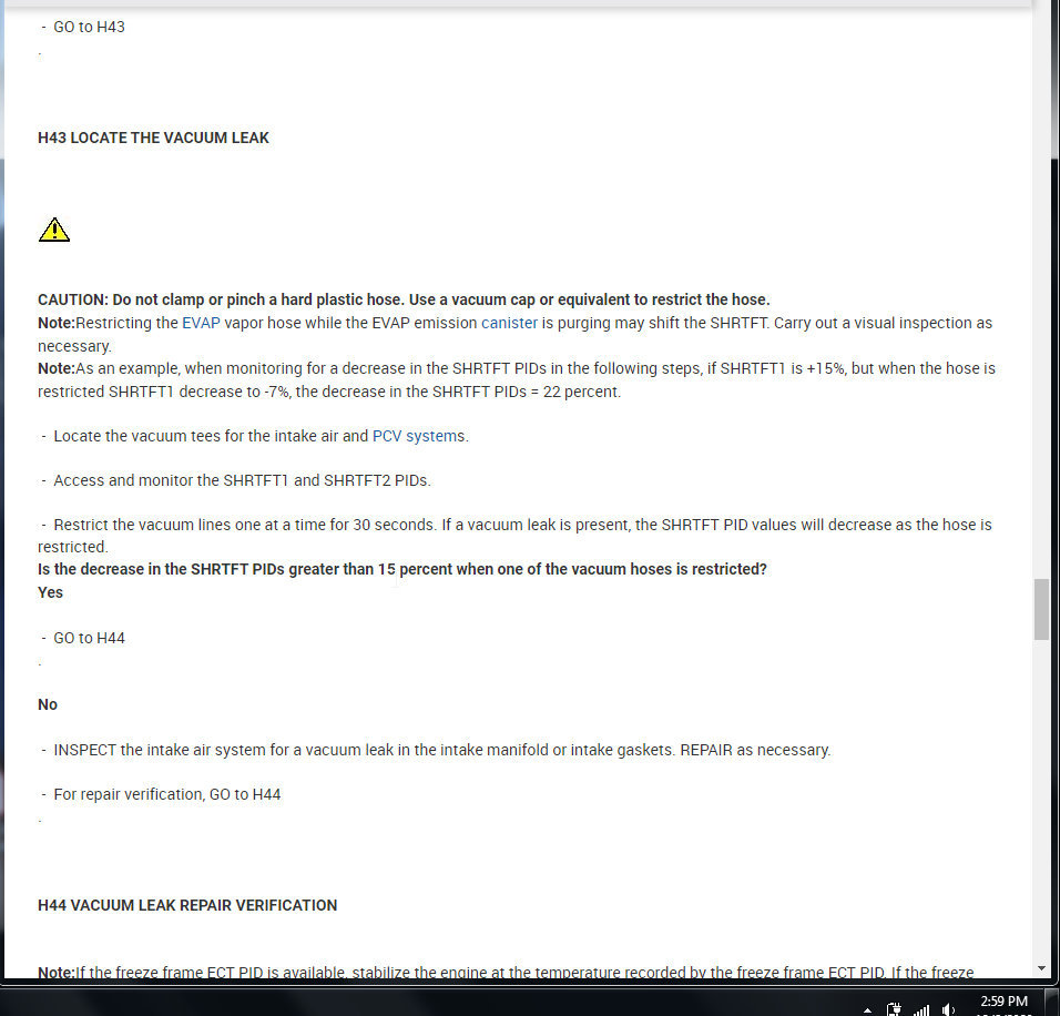

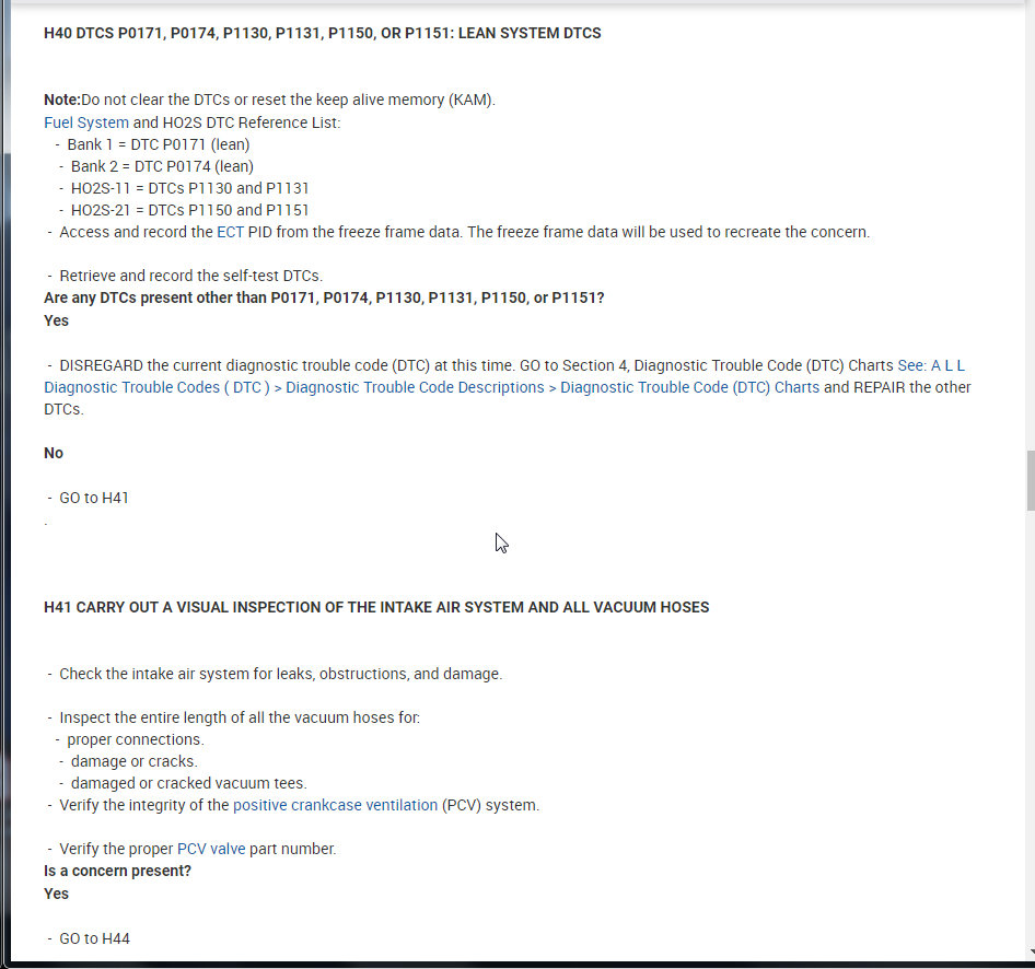

I am attaching all the info that you need for this. I would suggest starting with looking for a vacuum leak but I attached the testing that we need to do.
Here are some guides that will help as well:
https://www.2carpros.com/articles/repair-lean-mixture-codes-p0171-or-p0174-on-some-manufacturers
https://www.2carpros.com/articles/how-to-replace-a-mass-air-flow-sensor-maf
Let me know what questions you have. Thanks
