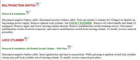

do you have to disassemble the dash to replace if so how do you do it?

Hello and thanks for donating To replace the combination switch you just have to disassemble the steering column, not the entire dash. The steps are below for replacing the switch..
https://images.2carpros.com/forum/automotive_pictures/261618_Noname_2673.jpg
