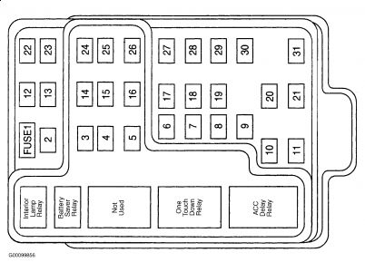

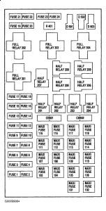

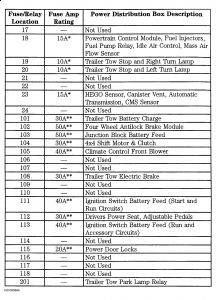

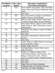

in my manual I can not find the fuse that runs either the electric windows or the fan moter please help
Saturday, March 14th, 2009 AT 2:38 PM
MERLIN2021
MECHANIC
17,250 POSTS
Power windows is #14 = 15 amp fuse inside car panel, Blower is in box under the hood # 105 40 amp maxi fuse.
