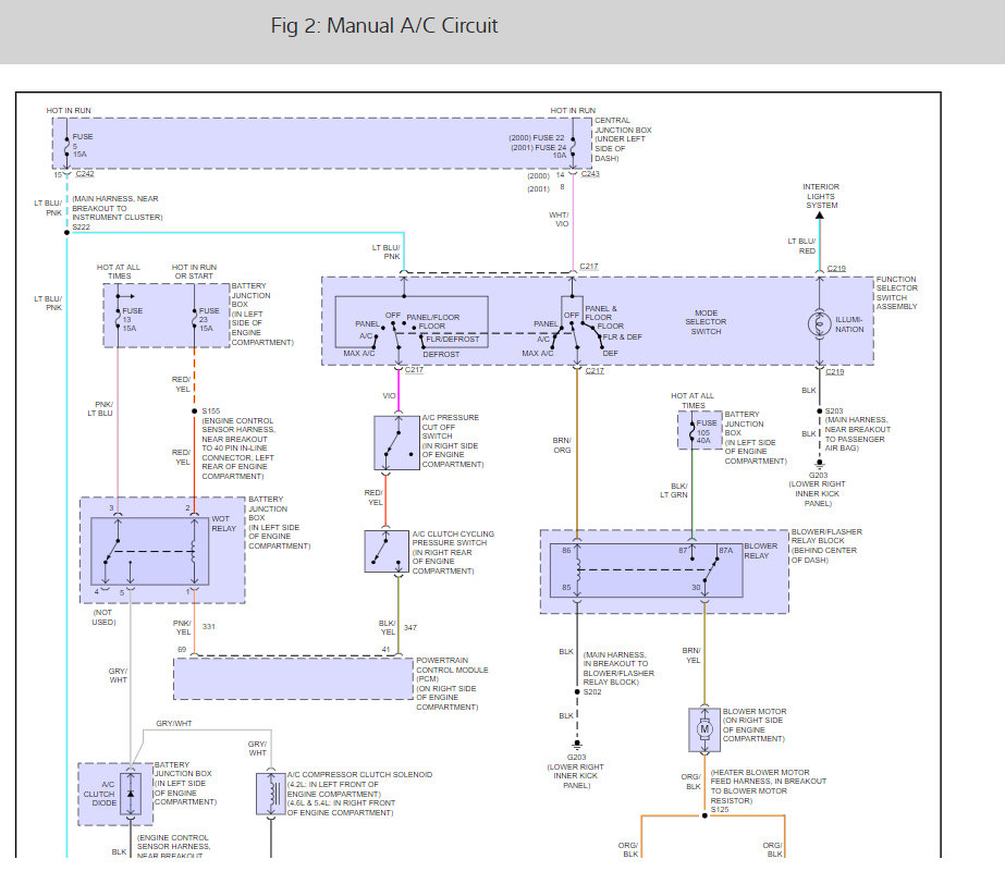

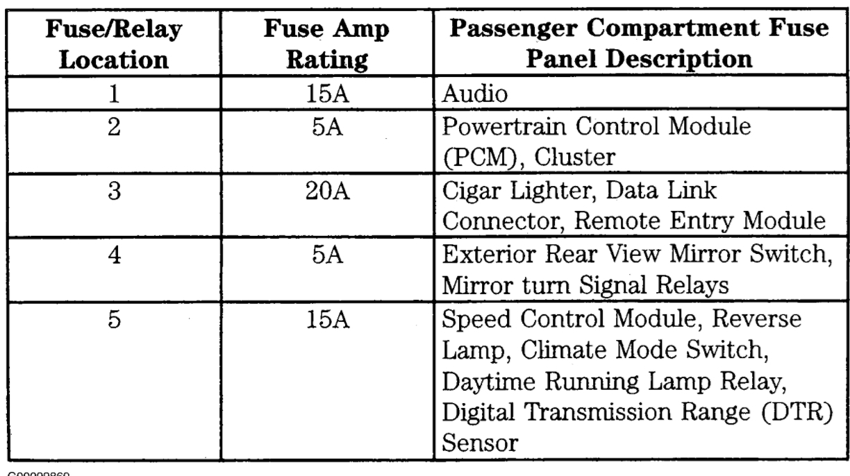

My ford f150 blows fuse #5 when I run ac or heater after about 5 min. Of running them, and then will stick in the cool or hot mode which ever one Im using and wont let ac work or heat adjust which ever one it is stuck on any help for me

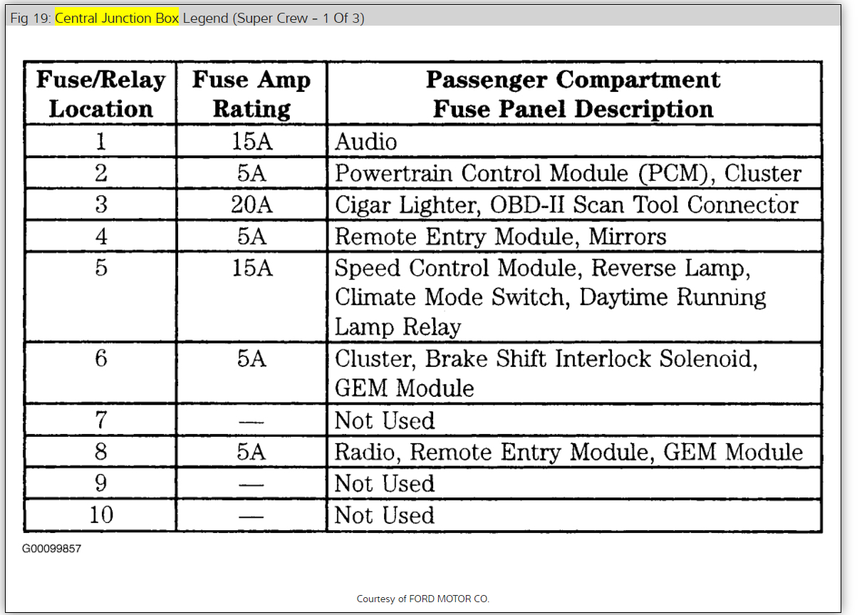

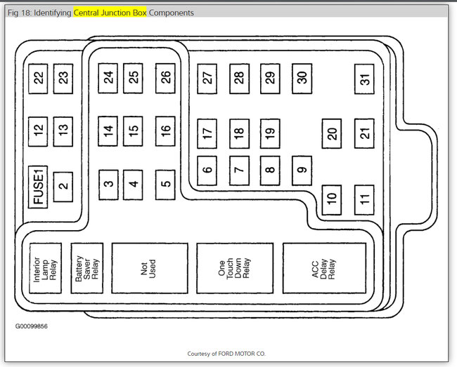

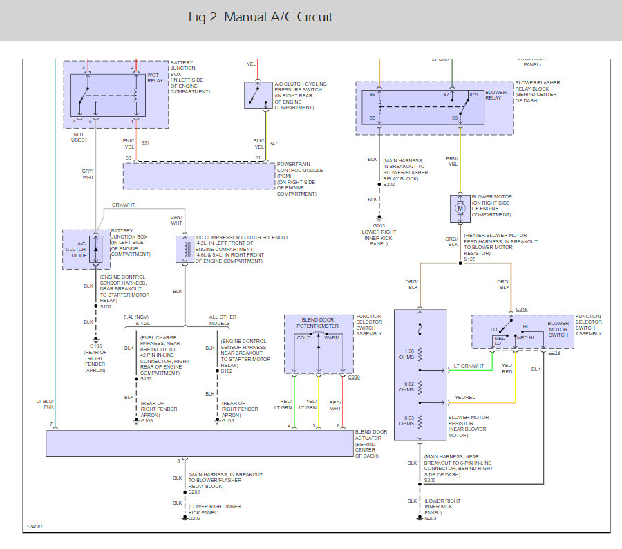

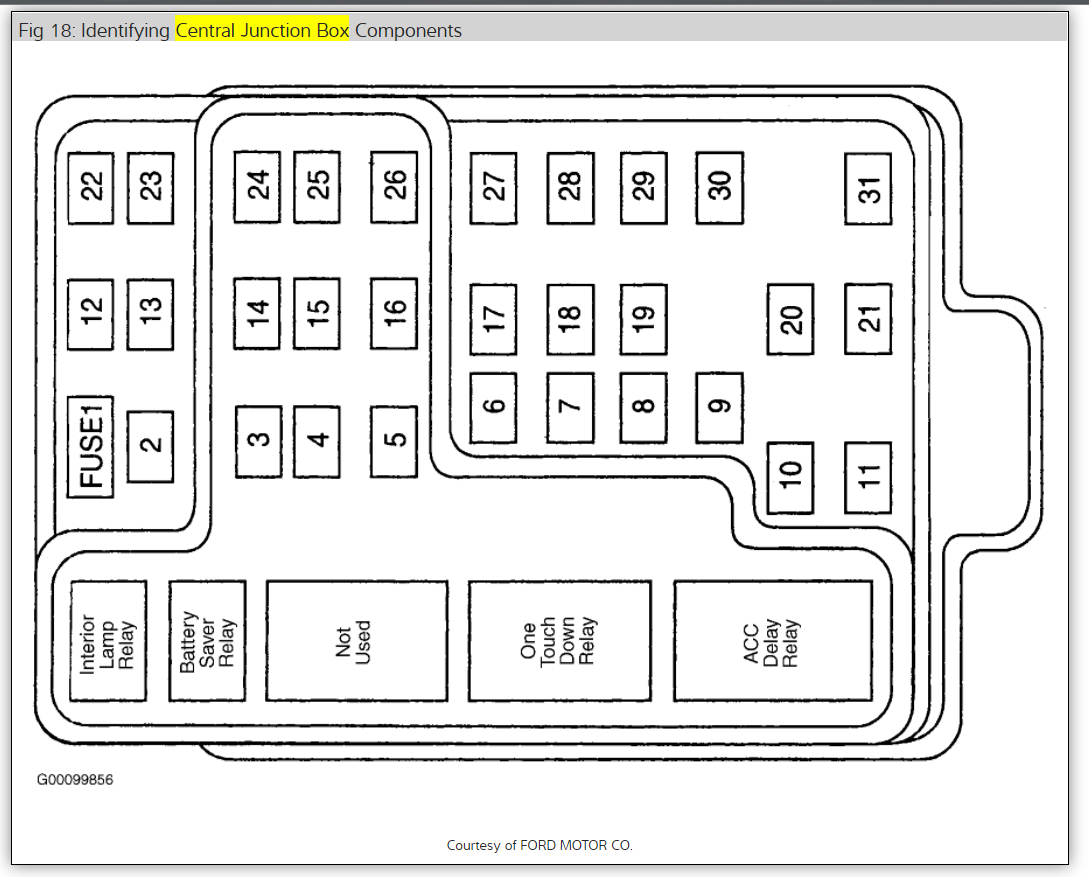

Lets try removing the compressor clutch trigger wire and replace the fuse. Here are wiring diagrams that show how the system works below. Also I have included the fuses just in case.

You are a genius! I replace the fuse and disconnect the compressor and the problem is gone! I guess I need a new compressor.
