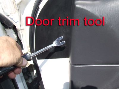

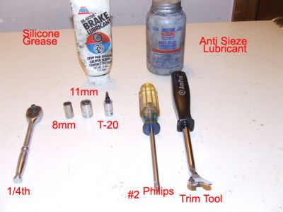

attempting to replace, difficulty accessing a yellow clip holding one of the internal rods, was actually looking for a schematic of the door to assist. have dissasembled as much as I can and can't determine how to get inside to remove clip without breaking it off. any assistance/guidance would be greatly appreciated.
Jun 15, 2008 at 8:50 AM
MERLIN2021
  • 17,250 POSTS
https://images.2carpros.com/forum/automotive_pictures/62217_Trim_Panel_021_1.jpg

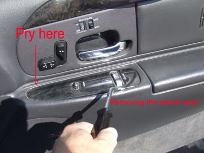

The tools on the bottom are the ones you need to remove the trim panel. Drill the rivet out at the bottom of the door, if the rivet is already missing, the actuator could be OK! This rivet requires a large riveter. Place the trim yool under the plastic clip and pop, there will be 8-10 of em, the grab handle will be removed with the Torx T-20. 2 Screws at the bottom of the door are removed with the philips.
https://images.2carpros.com/forum/automotive_pictures/62217_Trim_Panel_002_1.jpg
https://images.2carpros.com/forum/automotive_pictures/62217_Trim_Panel_014_1.jpg
