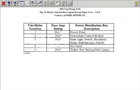

Tested for drain and found from fuse box. Fuses are not labled only numbered. Is there a manual that idenifies fuses? Thanks for help

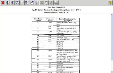

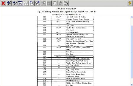

  • 75,992 POSTS
https://www.2carpros.com/forum/automotive_pictures/12900_f1_8.jpg
https://www.2carpros.com/forum/automotive_pictures/12900_f2_7.jpg
https://www.2carpros.com/forum/automotive_pictures/12900_f3_3.jpg
https://www.2carpros.com/forum/automotive_pictures/12900_f4_2.jpg
