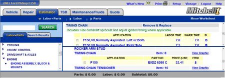

I believe that the timing belt on my "01 150 is the problem. It started making a rubbery clattering noise about 2 months ago when first started the truck, and the noise is constant now. Any suggestions/and or how much it would cost for the repair?

Hi suzieq19, Welcome to 2carpros and TY for the donation You don't have a timing belt-what you got is a timing chain-listen closely on the front of the engine cover for rattling noises and also have all the drive belts and pulleys inspected- If it's the timing chain-see below quotes-estimates varies with location
https://images.2carpros.com/forum/automotive_pictures/12900_timing_chain_8.jpg
