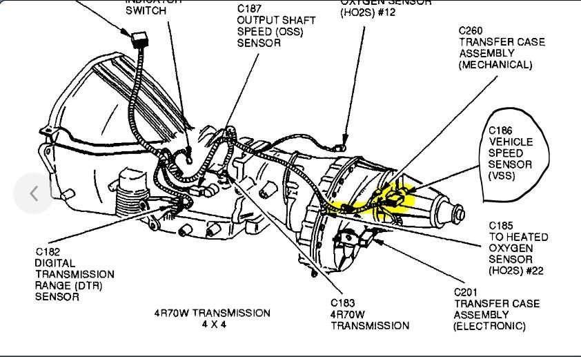

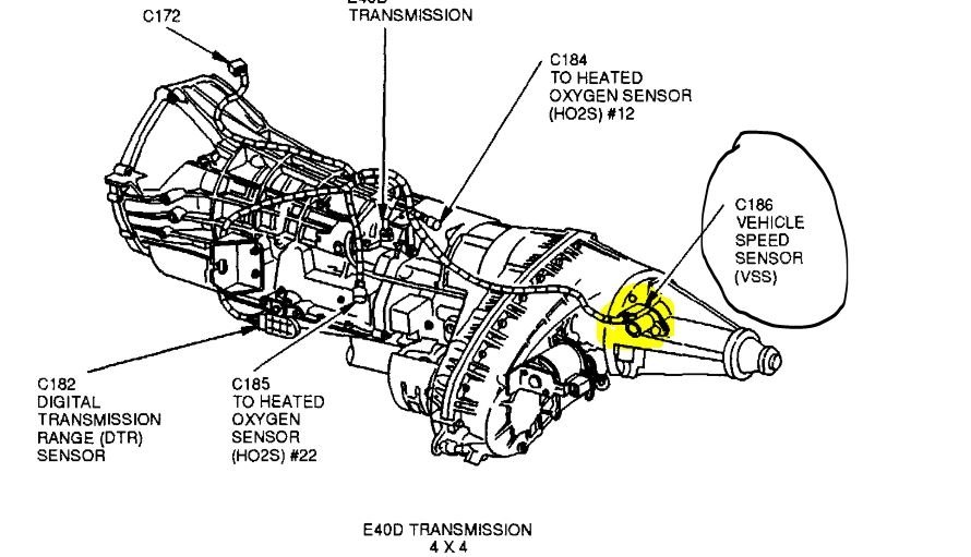

Your VSS IS located on the tranny. It is hard to locate so it is usual overlooked. The VSS was mounted on the differential on the 1998 F150's and older, not on the 2000 model. A couple of pictures are below to help you identify the VSS. The VSS may be causing your symptoms you listed.

Next, I attached two pics. They are two optional transmissions for this vehicle, and not knowing which you have, I attached both. Is the highlighted sensor the one you replaced?
Mar 24, 2021 at 12:48 PM (Merged)
Z98F150
yes that is what i had replaced. i have the ford M50D tranny with a Manual shift on the fly Transfer case

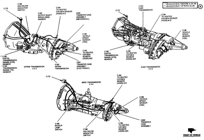

my speedometer is not working and I have a P0500 code. I need to know where the speed control sensor is located. Is there a test so I can confirm it is the sensor? Would also like a sensor diagram for my truck specs listed above.
  • 54,849 POSTS
The vehicle speed sensor is in the rear part of the transmission or transfer case if 4x4.
Here are some diagrams to show you (below)

Thanks for the diagrams. Very hepful

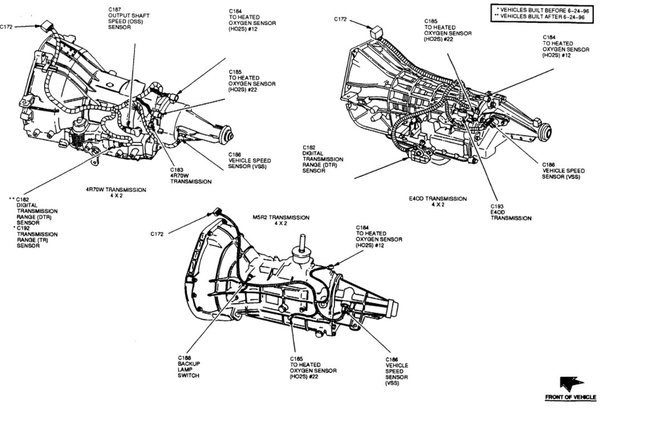

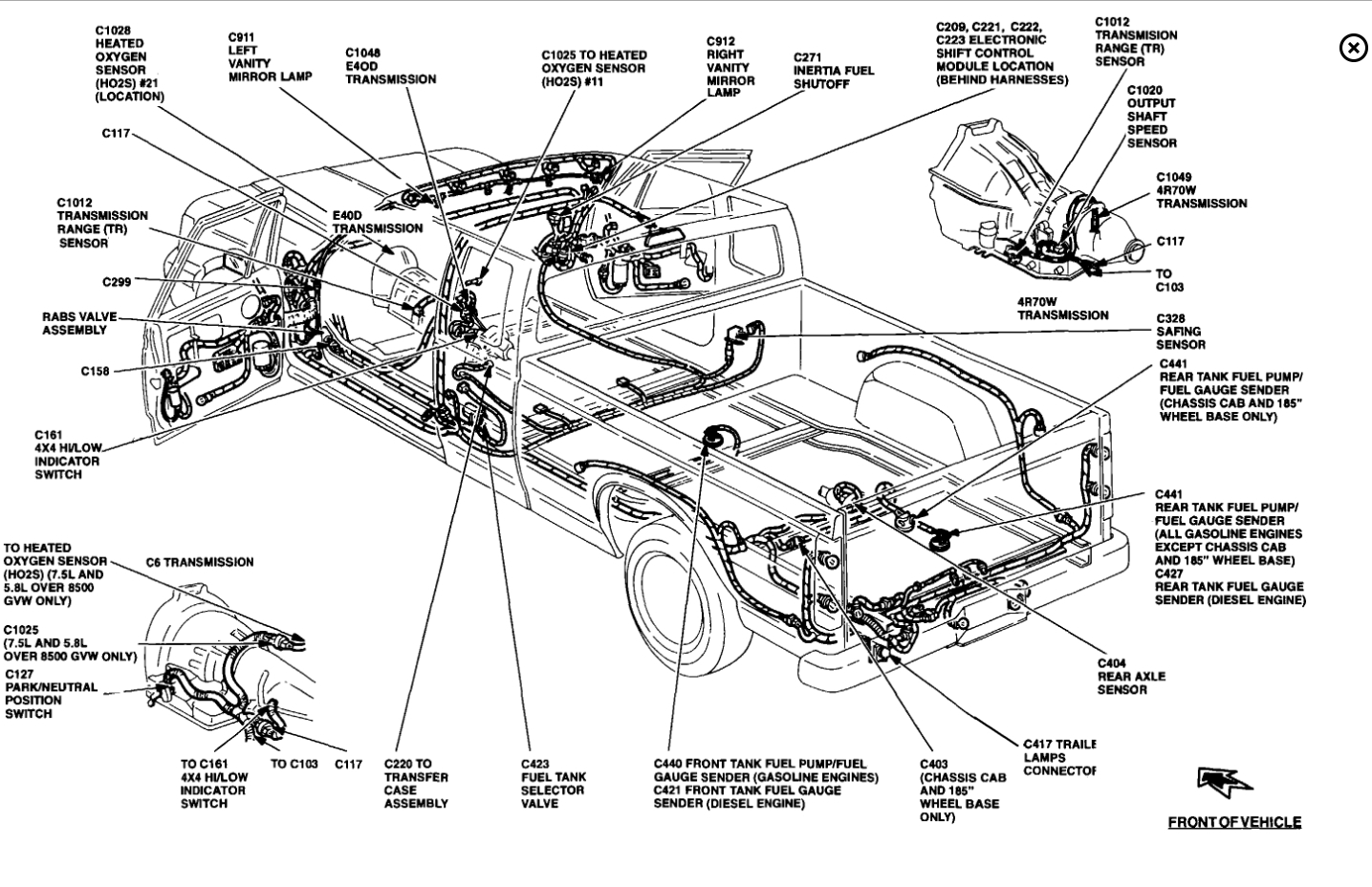

GATORNAPPER
Old computer quit working. New one (second new one) will not shift transmission properly, shifts from first to overdrive at ten mph. Throwing P0720 code, output speed sensor Ckt. malfunction.
I am a pretty good mechanic, have my own shop.
Cannot find output speed sensor! Not where shown on different drawings for E40D transmission. Not on driver side of transmission case, not on rear tailpiece of transfer case.
Hoping replacing output speed sensor will fix problem, it is the only code I am getting.
Never had any shifting problems prior to changing computer. By the way, paying $125.00 to have computer newly programmed did not help either.
  • 54,849 POSTS
The output speed sensor is on the transmission on the drivers side here is the location. Check out the diagrams (below). Please let us know if you need anything else to get the problem fixed.
