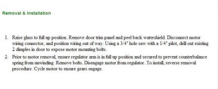

How do you replace the motor to the driver side window. AAll I could find said to drill 3 holes just under the mirror at the dimples but... no bolts were located there. Picture link would be nice.

https://images.2carpros.com/forum/automotive_pictures/261618_Noname_1104.jpg
