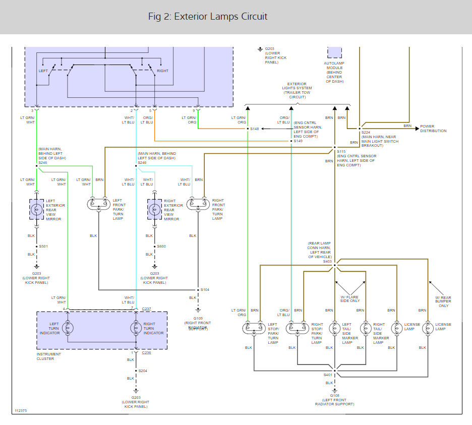

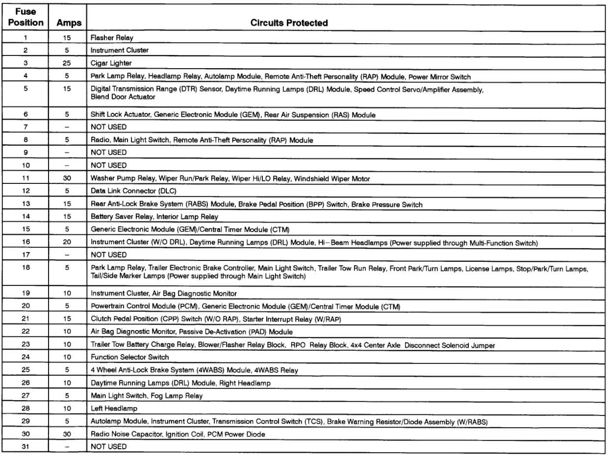

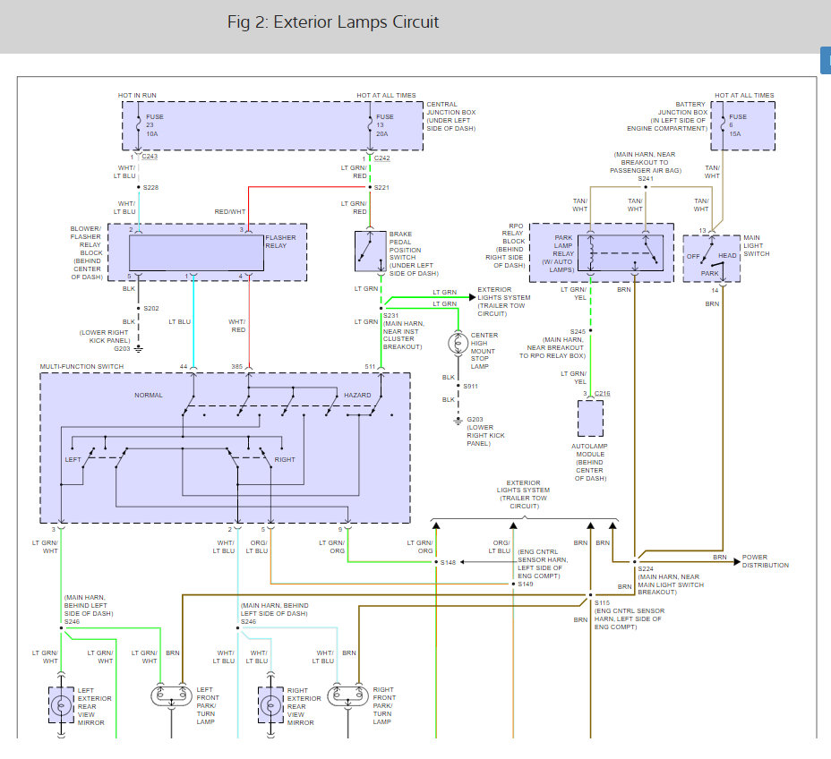

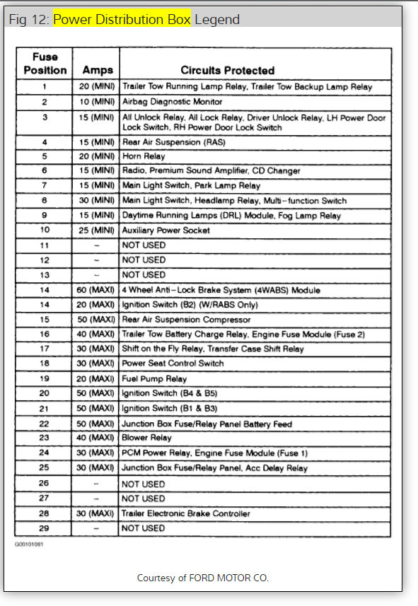

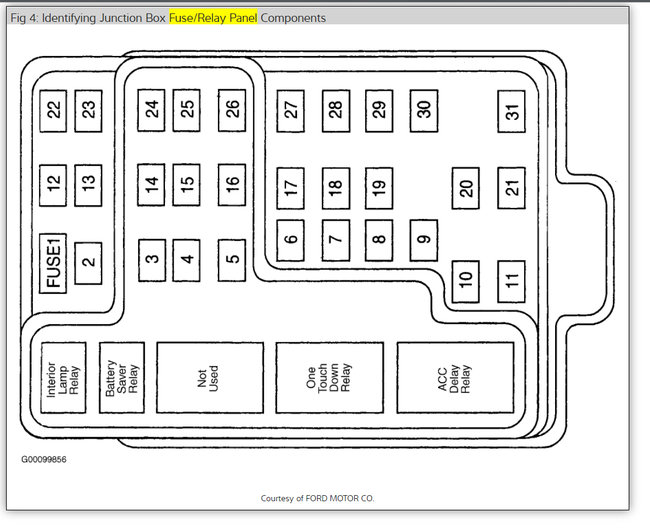

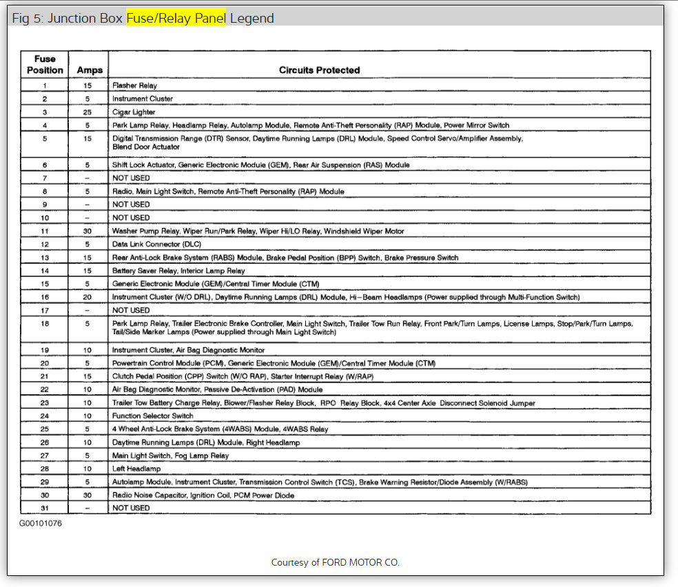

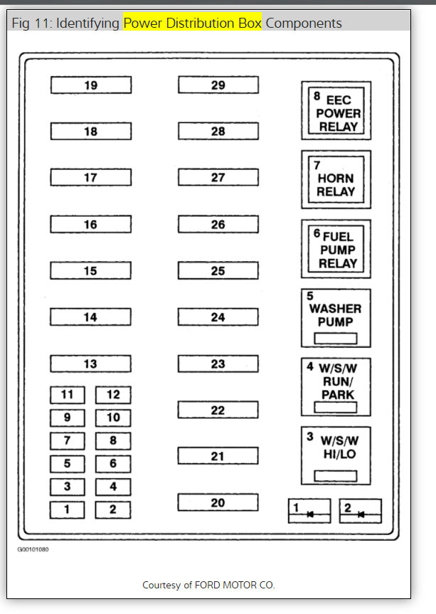

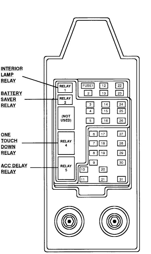

I show a blower flasher relay block under the hood in the relay center. But you say that you have flashers in the fuse block. Have you checked the brake lights do they work as they are tied together? Here are the blinker wiring diagrams and fuse panel locations and identifications.
Cheers

Brake lights work fine. truck manufactured in march 1999 . Flasher relay sits next to hazard relay to the right of the steering column, by themselves, not in the "fuse block" (I can feel each one click as I engage the turn signal or hazard. Is there another relay I'm missing. Taking the entire center dash off is a pain but I'll have to do it. Haynes manual lists the blower/flasher relay on elec. diagram and says it's located behind center dash but doesn't show picture. (This interested me since my blower fan just quit amidst this turn signal nightmare.) All I know now is when I try to follow the wires out of the flasher relay they go toward the center dash as they disappear from my sight with my head wedged next to the gas pedal. Am I gonna find another relay or link in the turn signal circuit if I dismantle the dashboard?

[quote:683ad23e70="racefan966"]No they don't. I do figure that if the engineers had to work on what they put together it would be. Let me know how it is going and if you need any help just let me know.[/quote:683ad23e70]Yeah, I do need help. Here's a funny story. The whole time I thought I was replacing the turn signal/hazard relay, I was replacing the blower motor relay. They sit right next to each other, just like the haynes wiring diagram says. Apparently this is what made my blower motor fail to work. After figuring this out, I put the original blower motor relay back and it worked. Yayyy! Sad part is the turn signal/hazard relay(ford's is a blue color) is still intermittent. I wiggled jiggled probed, etc. and that's doing nothing. I bent the relay blades a little and scuffed em up with a wire brush to improve the connection and I get the signal to work for 10 clicks then 6 clicks then 2 clicks, then nothing. But the hazards still work all the time without fail. I used a test light to determine which wires were the control and power circuit and which wire sent the power to the signal bulbs. ( When the flasher worked, the test light blinked in unison with the signal bulbs) Whoopdedoo! I still can't pinpoint the problem and the two new relays I bought won't make the signal work even one time. At this point it seems I'm either looking in the wrong spot or the new relays I bought got cooked when I put them on the blower motor socked or they were garbage to begin with. If you need another donation for a response, let me know. I need help.

[quote:e35a614adc="racefan966"]Ok have you checked the turn signal combination switch?[/quote:e35a614adc]I don't know what the turn signal combo switch is, but I do know this. I put the new turn signal/hazard relays in the blower motor socket and they both burnt out. Talk about bonehead manuevers of the year. For all future f150 turn signal relay problems, make sure you replace the BLUE relay, that's the turn signal/hazard relay. The one next to it is black, and it runs the blower motor, and it will cook your new signal relay if you plug it in there. Thank you 2carpros, you didn't help, but you did give me a place to vent my frustration.

First off how did I not help? You were taking advice from someone other then any of us that are the mechanics. Here is a pic of the turn signal combo switch.
