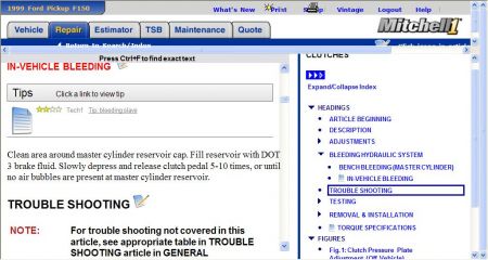

1999 Ford F150 No pressure on my clutch pedal
1999 FORD F-150
130,000 MILES • V8 • 4WD • MANUAL
BRANCH0216

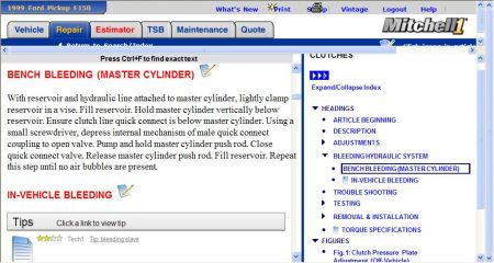

where can I check the fluid for my master cylinder and what kind of fluid does it take?
Oct 12, 2008 at 9:57 AM
  • 75,992 POSTS
1999 Ford F150 No pressure on my clutch pedal Find the clutch master cylinder bleed there then the clutch slave-use brake fluid DOT3/4
