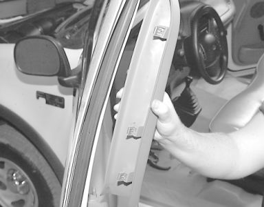

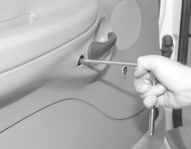

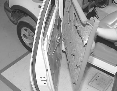

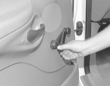

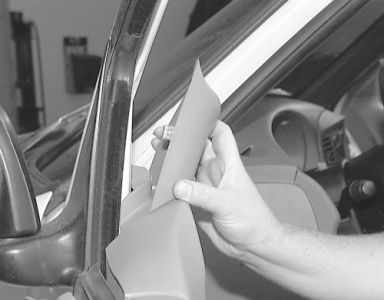

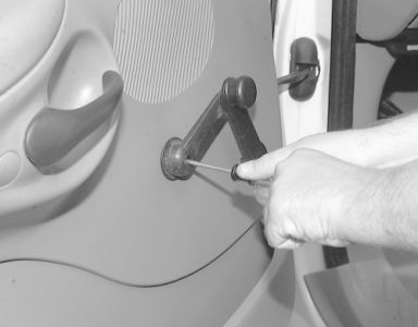

Door panel removal instructions are below. REMOVAL: Disconnect the negative battery cable. Remove the front door sail panel. Remove the inside door handle finish panel. If equipped with power windows, remove the window regulator switch plate. If equipped with manual windows, remove the window regulator handle by separating the handle cover from the handle. Remove the handle retaining screw and remove the window regulator handle and the spacer. WARNING Do not pull directly outward on the front door trim panel, as damage may occur. Remove the door panel retaining clips. Remove the door panel retaining screws. Lift and remove the front door trim panel. If equipped, twist the courtesy lamp bulb socket one quarter turn and remove the socket from the front door trim panel.
https://images.2carpros.com/forum/automotive_pictures/261618_0900c152801e5b1b_1.jpg
https://images.2carpros.com/forum/automotive_pictures/261618_0900c152801e5b1c_1.jpg
https://images.2carpros.com/forum/automotive_pictures/261618_0900c152801e5b1d_1.jpg
https://images.2carpros.com/forum/automotive_pictures/261618_0900c152801e5b20_1.jpg
(((Removing the door pillar trim by carefully puling it outward to release the trim clips)))
https://images.2carpros.com/forum/automotive_pictures/261618_0900c152801e5b22_1.jpg
(((Removing the door panel by carefully lifting the panel upward to release the retaining clips)))
