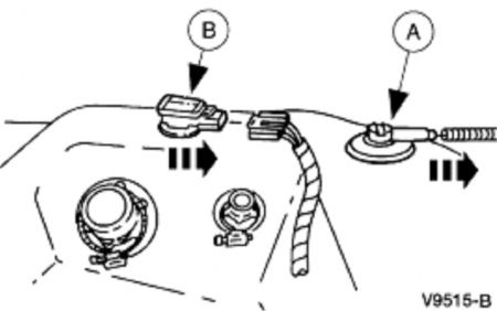

i replaced the fuel pump and fixed my problem but when i was replacing hoses to the tank i broke one of the two check valves on the tank. i dont know what these valves are called so i have no idea where to start when it comes to trying to order the part. its a green valve,appears to be a check valve going into the tank from a return line. please help with part identification and nomenclature

Is it "A" in this picture? It's the vent valve
