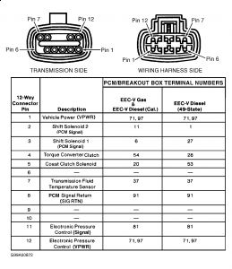

where is this part located on the transmission my overdrive botton light is blinking and truck jerks and slip from 2 to 3

P1747 EPC Circuit Shorted Or PCM. (Output circuit check, generated ONLY by electrical conditions.) tech tip By WATERLOO TRANSMISSION quick tip on P1747. Make sure you pull the pan before doing any diag.. Most of the time the trans is wiped out with a lot of clutch material and fine metal. If not then you might have caught the problem before it took out the trany
https://images.2carpros.com/forum/automotive_pictures/99387_Graphic1_422.jpg
check wiring harness and suspect bad tranny if have a lot of material in tranny oil pan
