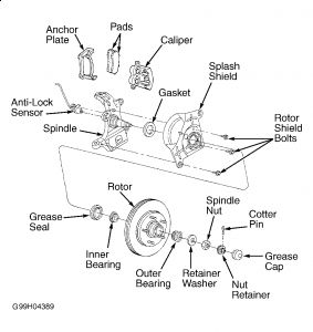

How do you change the front rotors on a ford f150 pick up
Saturday, August 1st, 2009 AT 3:25 PM
DOCFIXIT
MECHANIC
18,828 POSTS
Pull wheel remove caliper and mount. Remove center cap, cotter pin. nut washer. Pull off hub.
