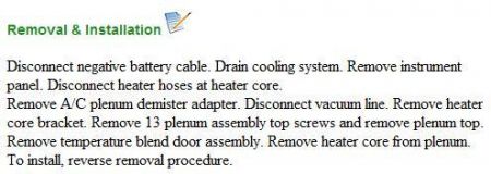

I HAVE REMOVED THE SCREWS AND BOLTS HOLDING THE DASH BUT THERE MUST BE ONE OR TWO SOMEWHERE I CAN'T SEE. THE DASH IS LOOSE ON THE LEFT SIDE OF THE GLOVE COMPARTMENT BUT WILL NOT BUDGE ON THE RIGHT SIDE. WHERE IS THE HIDDEN SCREW OR WHAT DO I NEED TO DO TO REMOVE THE DASH TO GET AT THE HEATER CORE?
