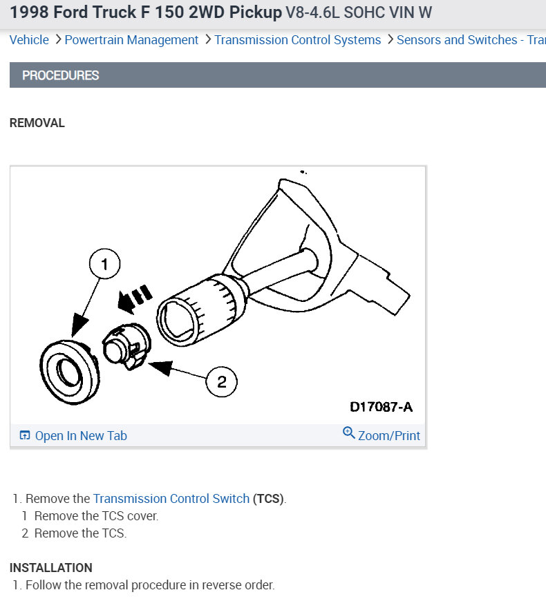

How did you change out the overdrive switch?

Here is how you change out the transmission overdrive switch. Check out the images (below). Please let us know if you need anything else to get the problem fixed.
