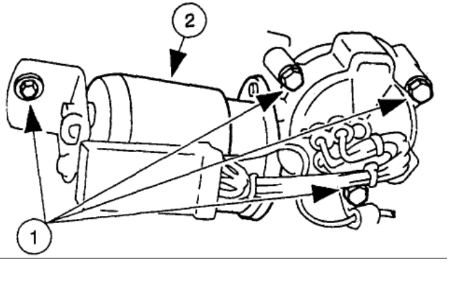

My truck will not shift into 4x4? Automatic floor shift light does not come on only when starting truck up then goes out. Thanks

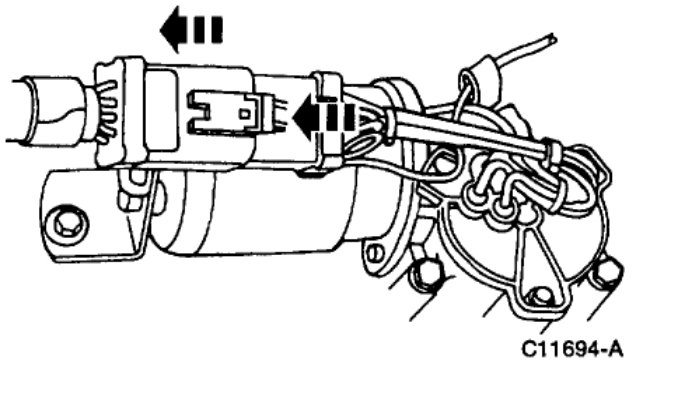

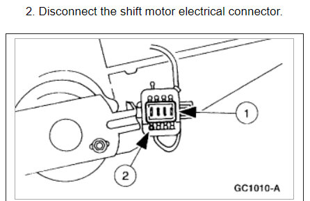

This sounds like you have a transfer case encoder that has gone bad. Here is a diagram to help you get it changed out. Check out the diagrams (Below)

Hey, that worked I replace the 4x4 actuator encoder and the truck works great, thanks 2Carpros :)
