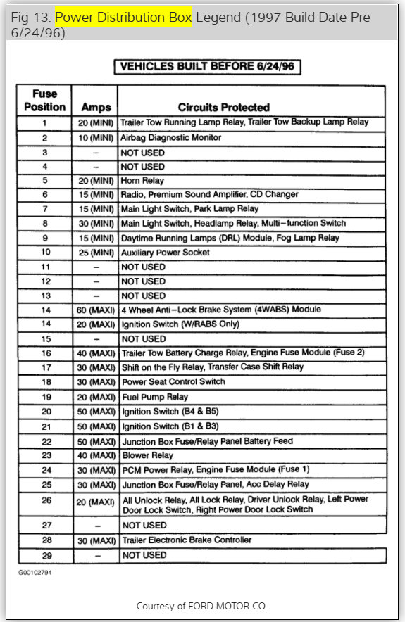

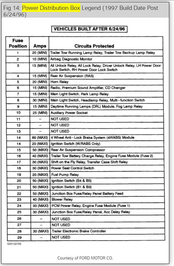

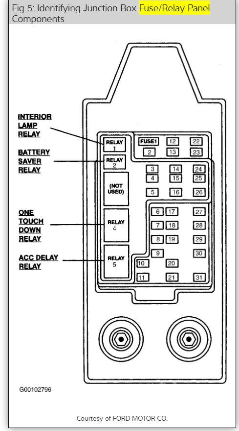

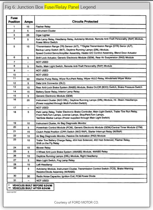

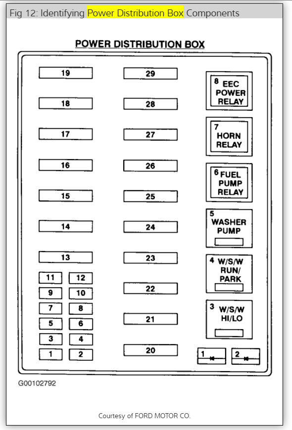

my wipers have stopped working and I am sure it is a fuse. Any ideas as to which number is the wipers. I don't have an owners manual. Thanks. Kris
Jan 14, 2008 at 1:29 PM
  • 54,840 POSTS
Here is a guide that will show you how to check the fuses and some diagrams that will show you the fuse panels and the identification. (below)
