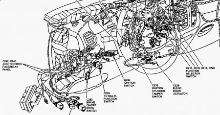

PAKS_26
OK. I have checked all of the fuses that I can find. Which brings me to my next question. Are there not any fuses inside the cab of the truck? The only fuses that I could find are under the hood on the drivers side. There are some really big ones and some tiny ones too. I removed and looked at all of them and they appear to be good. It just seems odd to me that there are none to be found under the dash somewhere.
I assume that by coil you mean the coil packs since there is no standard coil/distributor and when you say to check for power at the coil should there be power to them at all times when the switch is on or only when I attempt to crank the engine?

COMPUTERIZED ENGINE CONTROLS POWERTRAIN CONTROL MODULE (PCM) Ground Circuits 1. Using a DVOM, check for continuity to ground at PCM connector terminals No. 24, 25, 51, 76, 77 and 103. See Fig. 1 . Resistance should be approximately zero ohms. If resistance is not approximately zero ohms, repair circuit open to ground. 2. Touch negative lead of voltmeter to a good ground. With vehicle running, backprobe positive lead of voltmeter to each ground terminal. Voltmeter should indicate less than one volt. If reading is greater than one volt, check for open, corrosion or loose connection on ground lead. Power Circuits Turn ignition off. Using a voltmeter, check for battery voltage between ground and PCM terminal No. 55 (KAPWR). Turn ignition to START or RUN position. Check for battery voltage between ground and PCM connector terminals No. 71 and 97. If battery voltage is not present, power is not being supplied from EEC power relay. See CIRCUIT TEST B in TESTS W/CODES - 4.6L article. PCM LOCATIONS Fig. 1: Identifying PCM 104-Pin Connector Terminals Model Location Pickup Right Side Of Engine Compartment Page 1 of 1 SYSTEM/COMPONENT TESTS - 4.6L -1997 Ford Pickup F150 3/26/2009 src="http://www.2carpros.com/forum/automotive_pictures/62217_f150pcm_1.jpg" alt="http://www.2carpros.com/forum/automotive_pictures/62217_f150pcm_1.jpg" />
Check fuse # 20 inside the cab its for the PCM and GEM and fuse # 30, its for the coils. Fuse box is under left side of the dash.
http://www.2carpros.com/forum/automotive_pictures/62217_150fuses_1.jpg
