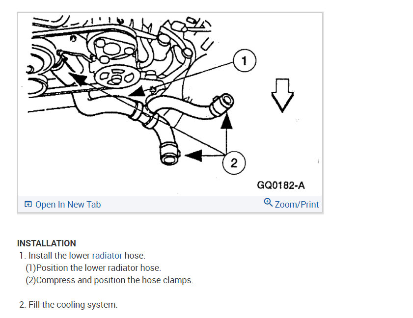

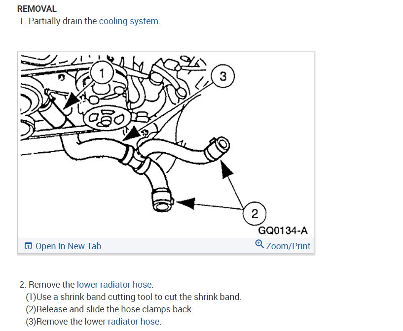

How do I change lower radiator hose?
Saturday, August 14th, 2010 AT 9:14 AM
MECHANIC
52,797 POSTS
Good evening,
I attached the procedure for you for the hose replacement.
https://www.2carpros.com/articles/replace-radiator-hoses
https://www.2carpros.com/articles/coolant-flush-and-refill-all-cars
Let me know if you have any other questions.
