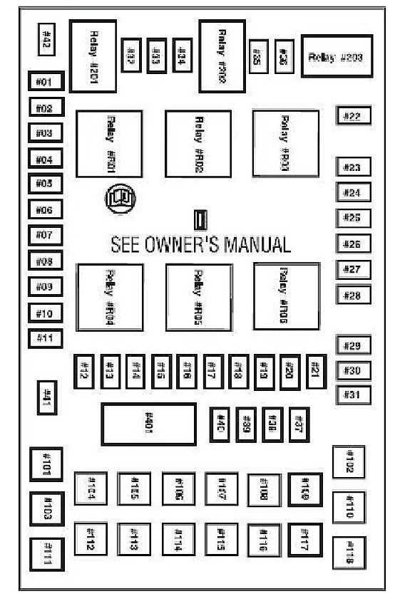

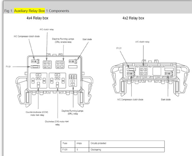

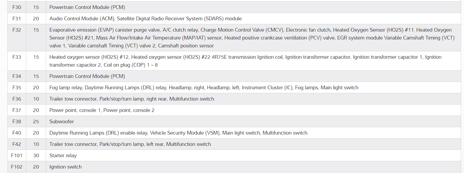

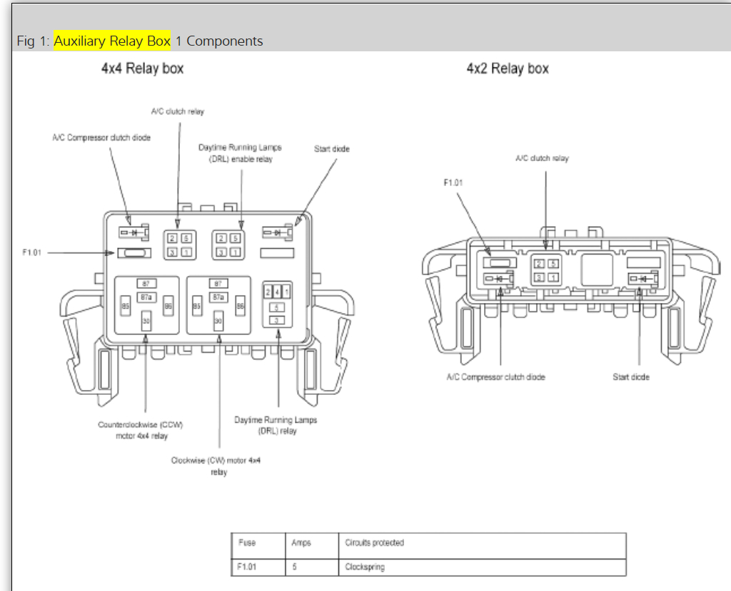

hi i was driving my truck and it just stalled in the middle of my street a couple houses down from my home. it appeared to be running fine, although i had heard some knocking when i would first turn on my truck. i contributed to the colder weather though. anywho a friend of mine cannot decipher the lines on the truck as they are not labeled anywhere. could you please post a diagram for the relay panel, id the relay lines etc.. also the master fuse panel box under the hood.thanks a billion.

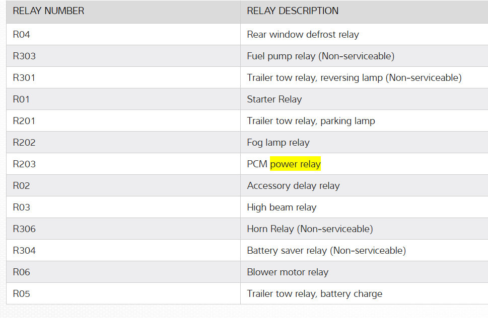

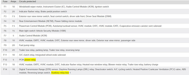

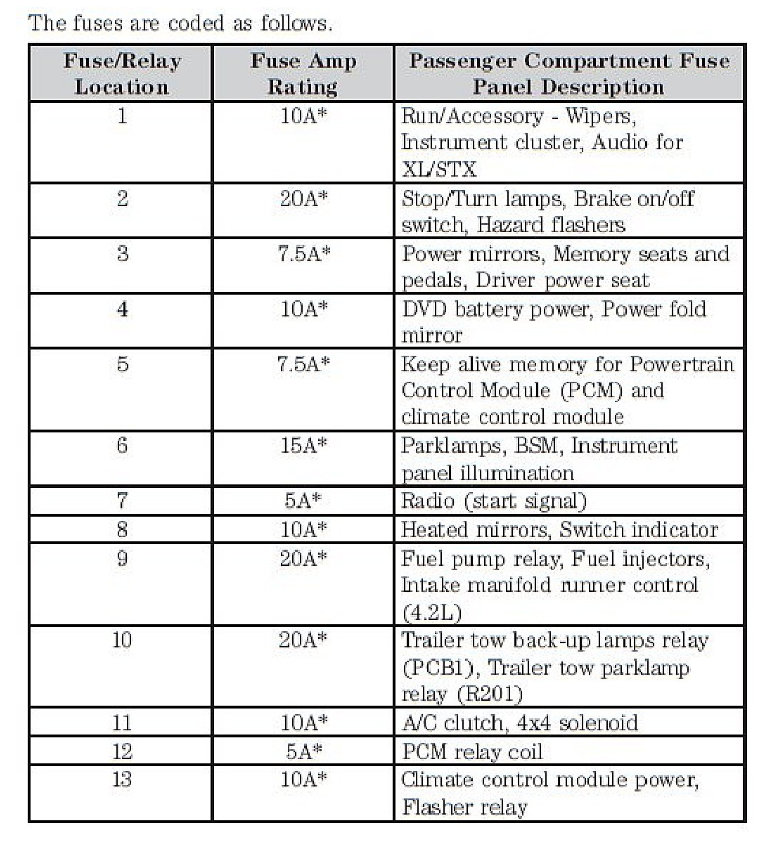

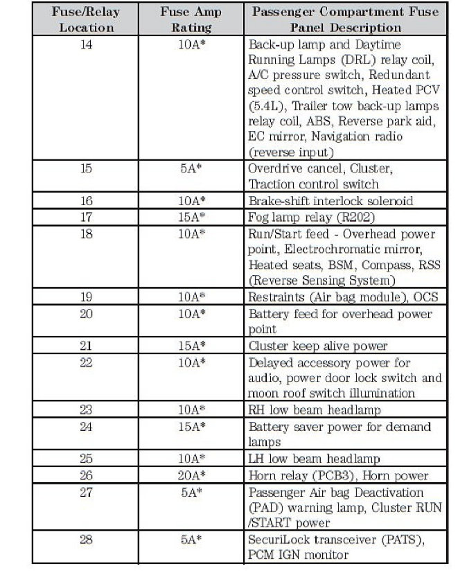

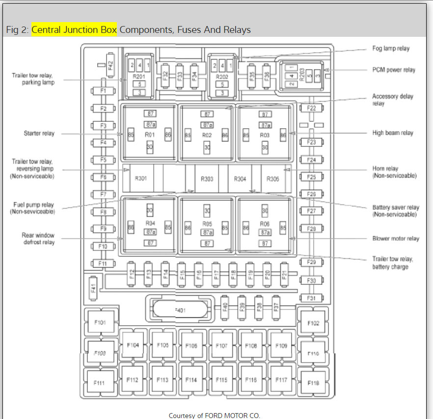

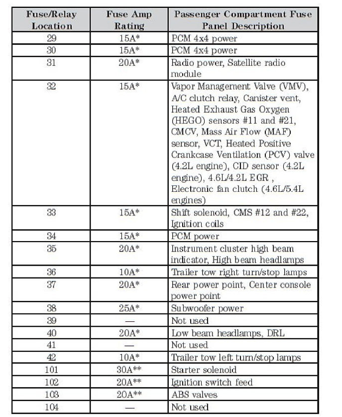

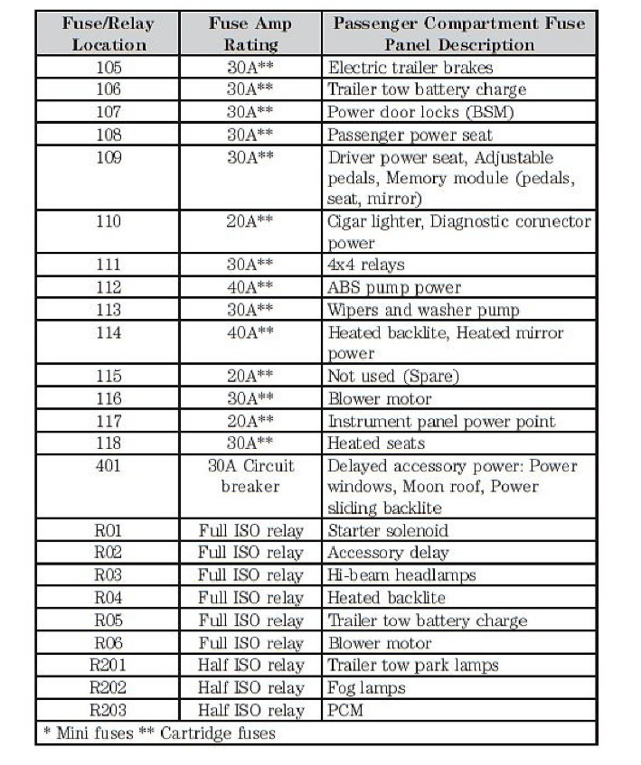

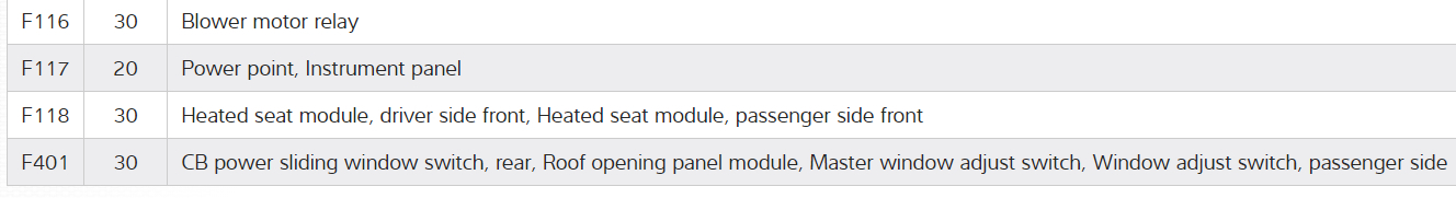

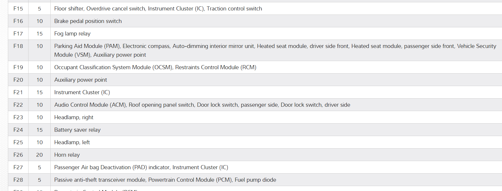

Called Power distribution box...here they are, but know this, there are 2 v8's 4.6 and 5.4...also 2 production dates, b4 and after 6/24/96 these are 4.6 after 6-24-96 OK?
This guide can help test the fuses with the fuse diagrams below.
