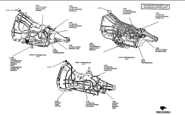

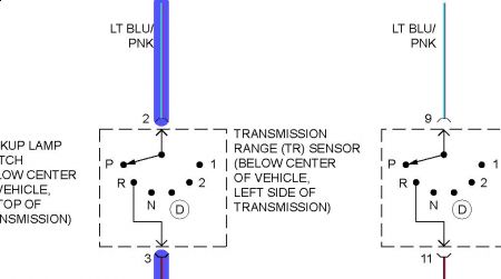

Where is the backup light switch and how do I replace it?
Sunday, September 13th, 2009 AT 4:35 PM
MECHANIC
75,992 POSTS
The back up switch is the transmission range sensor below center of vehicle, left side of transmission.
Image (Click to make bigger)
