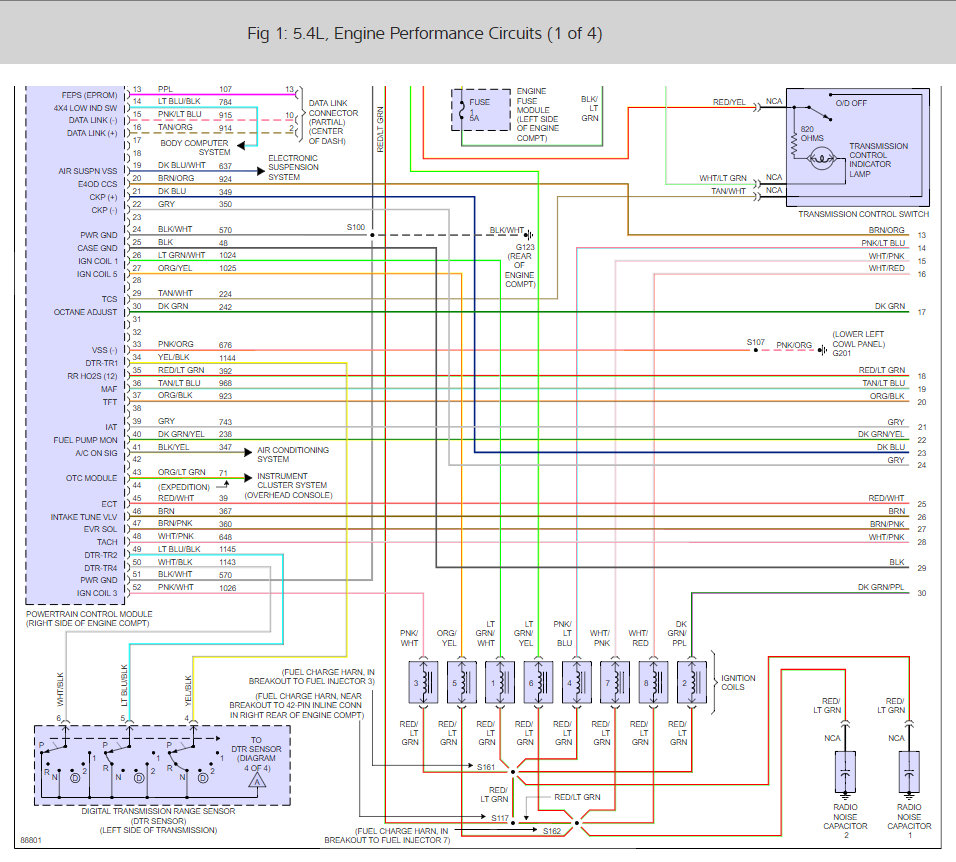

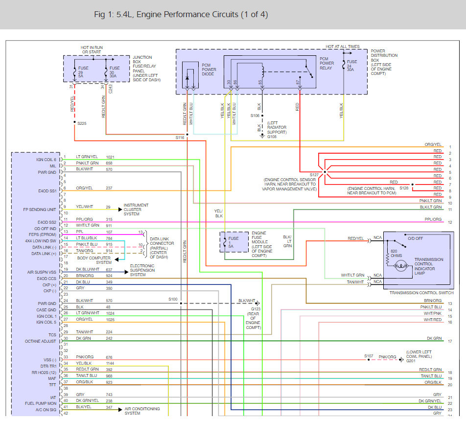

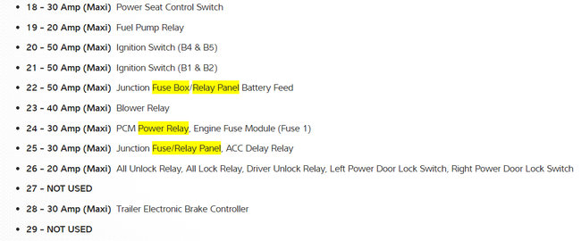

I have a 1997 Ford F-150 with 132,000 miles, 4.2L 6 cylinder engine. My truck keeps blowing the PCM fuse when I engage the ignition. The relay is fine... It used to finally turn over after changing the fuse 4 times, but now it will not turn over at all. I also have a check engine light that says the upstream O2 sensor is bad. I have no idea where to even begin with this problem.

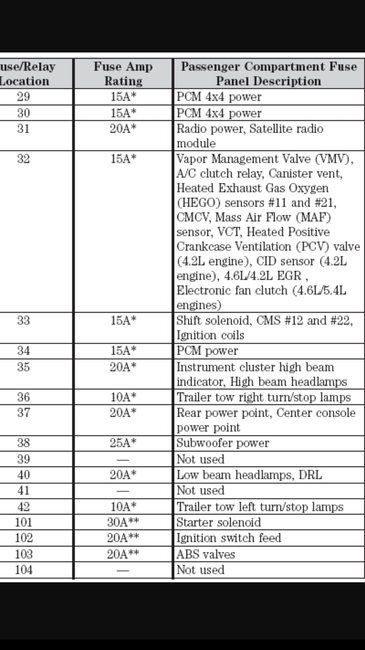

I tested f24, f30, and the MAF red wire. All three have power with the ignition in the on position.
Any advice would be greatly appreciated.

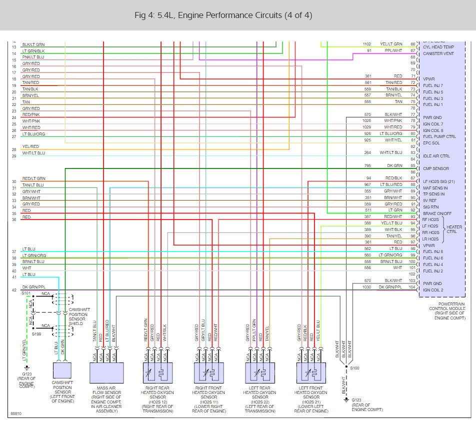

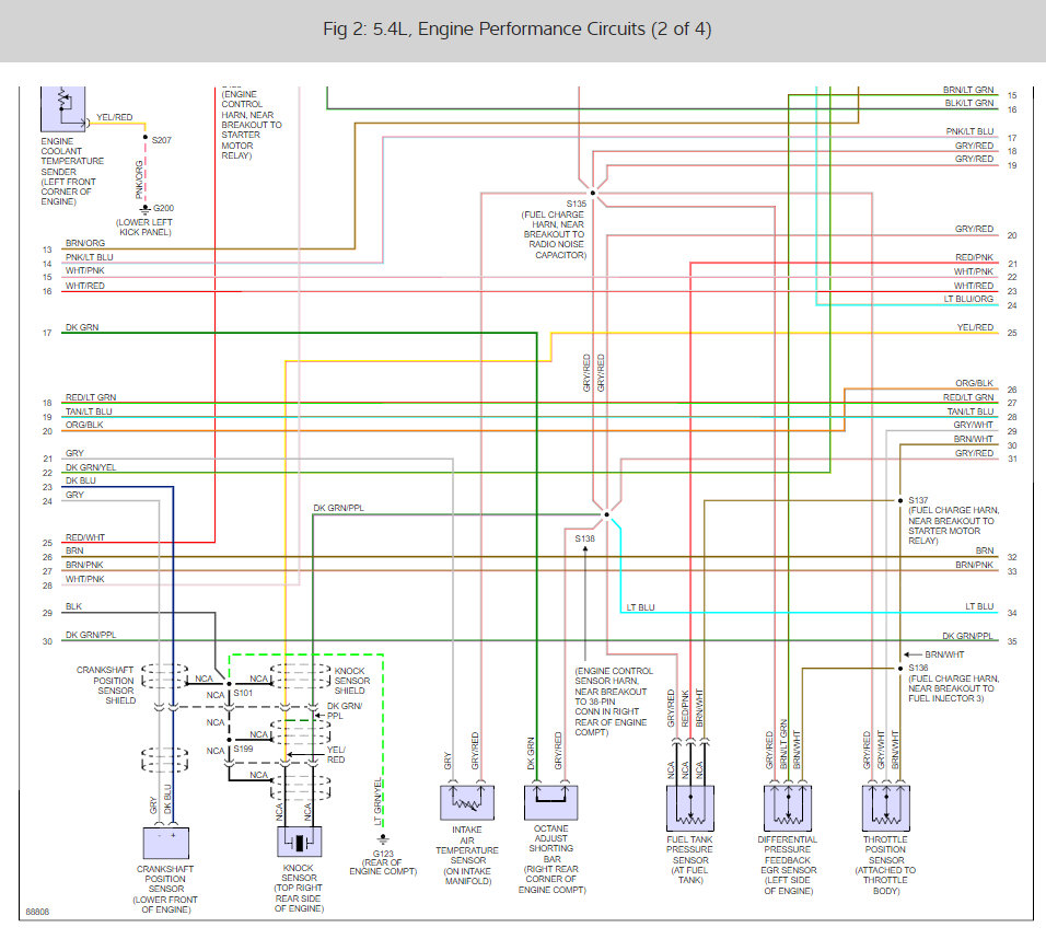

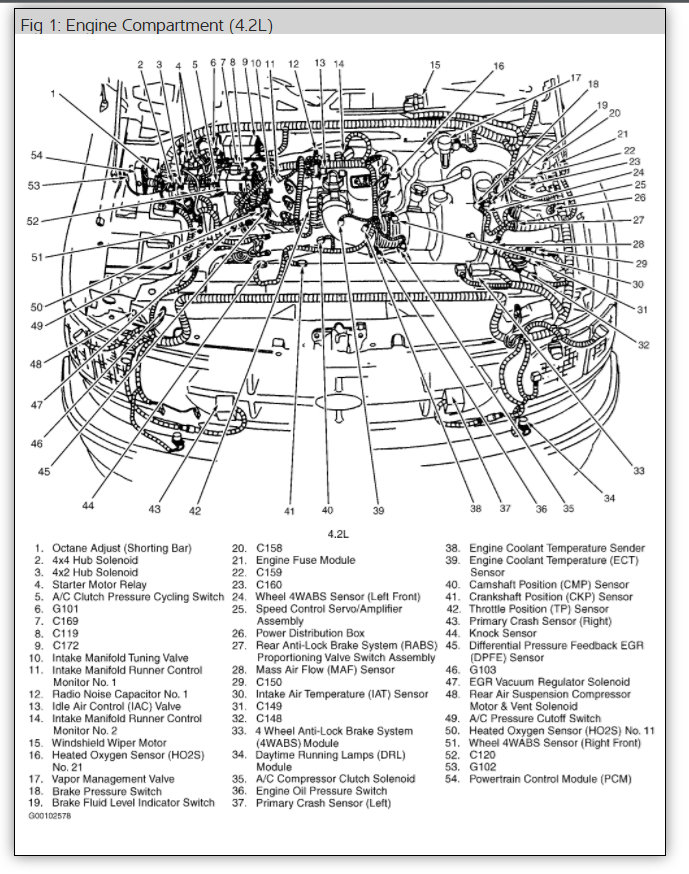

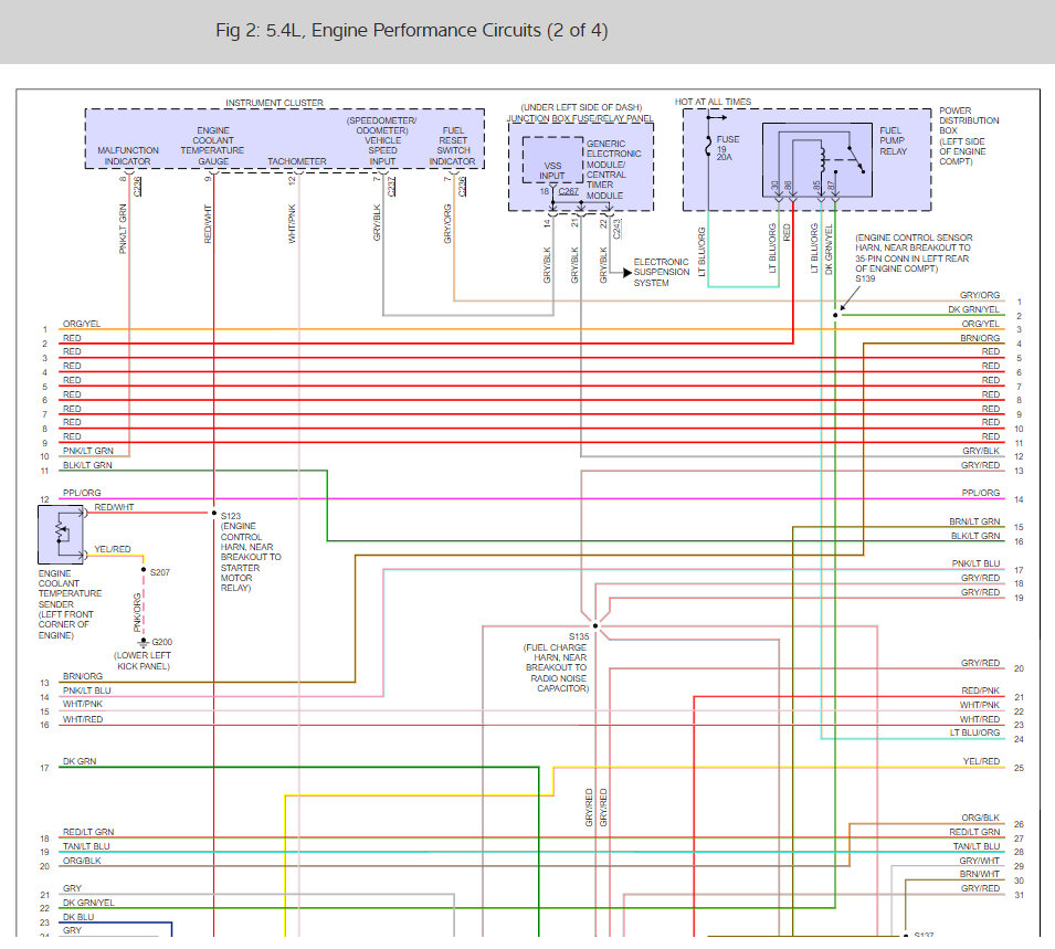

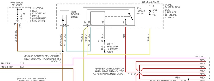

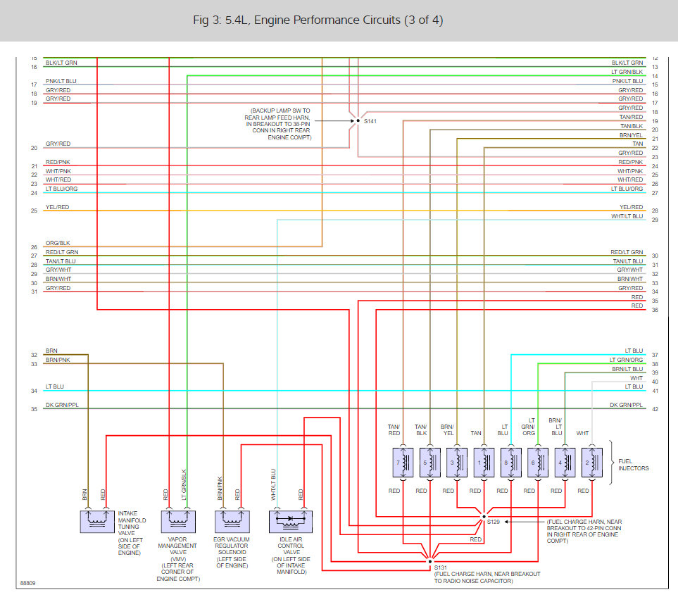

It sounds like you have a system power wire that is pinched or has rubbed through to ground. Here some guides and some wiring diagrams so we can do some testing and get the problem fixed.
What fuse # are you replacing and is it in the eng. Comp? When you say "engage the ignition" is that from OFF to RUN or RUN to START? Does your anti-theft light blink rapidly when it fails to start? Why do you think the PCM relay is fine? Do you have an aftermarket anti-theft or remote start system installed. Is this a man. Or auto trans? Your full and complete answers are needed to accurately diag. Your concern.
The fuse number is 24, and it is in the engine compartment. I believe the PCM relay is good because it does not look blown/bad. What I mean by engage the engine is from run to start. I have no anti-theft (factory or aftermarket) The truck is an automatic.
Please recheck the relay as well.

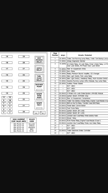

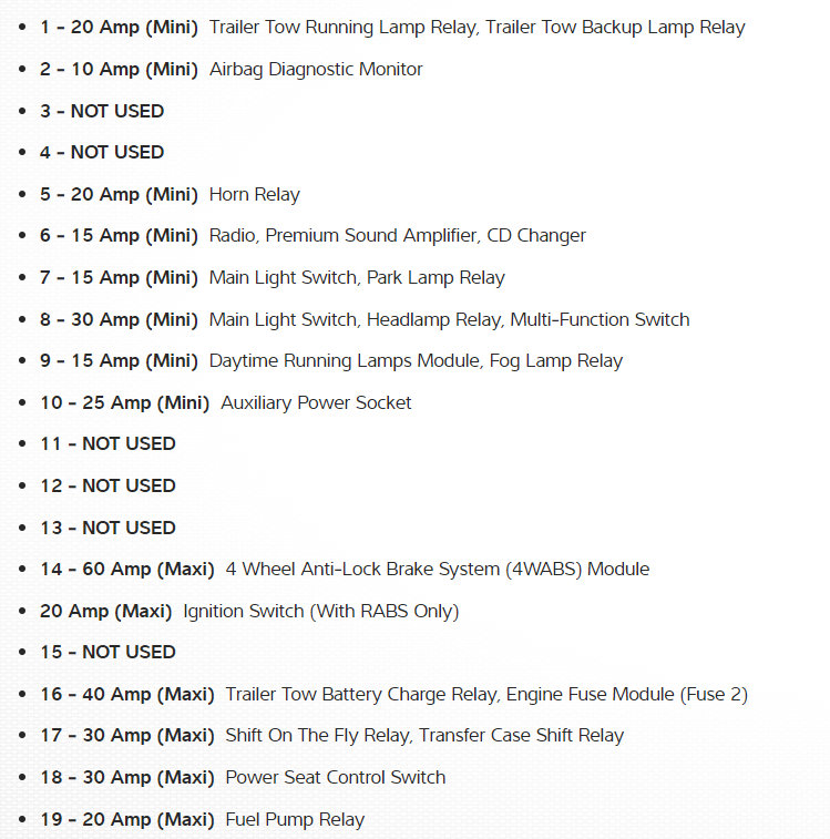

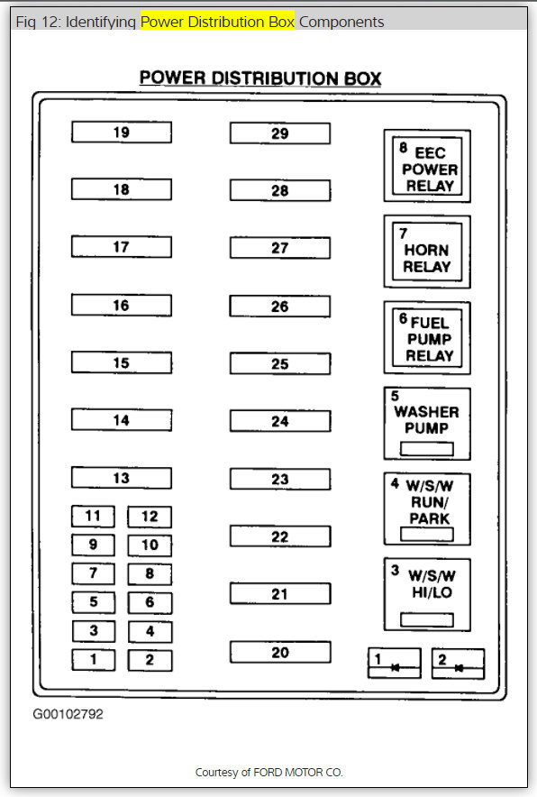

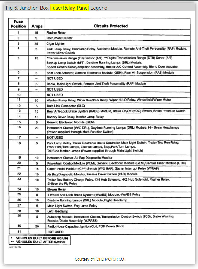

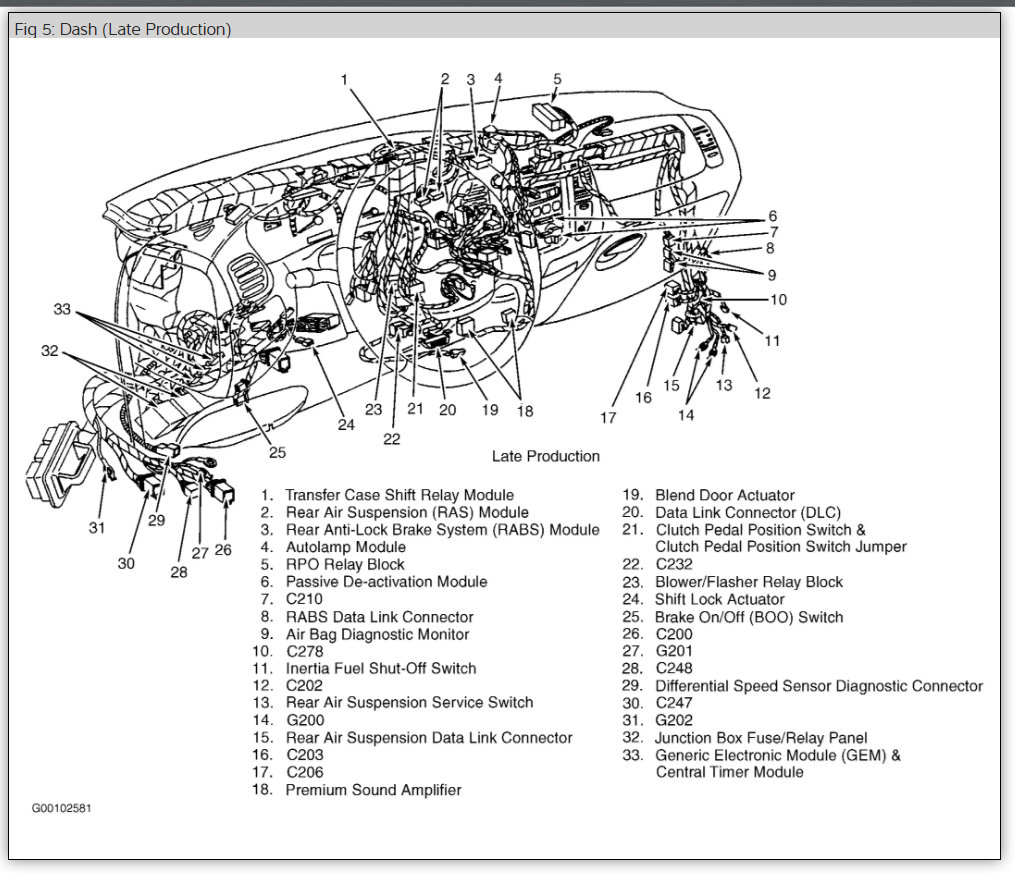

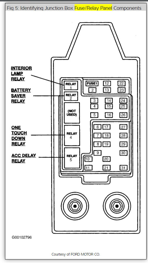

any idea where the engine fuse is located on a 97 f150?
Feb 12, 2019 at 2:05 AM (Merged)
PACO8224
  • 117 POSTS

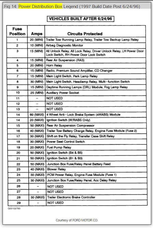

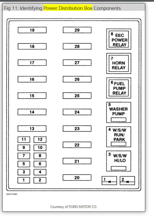

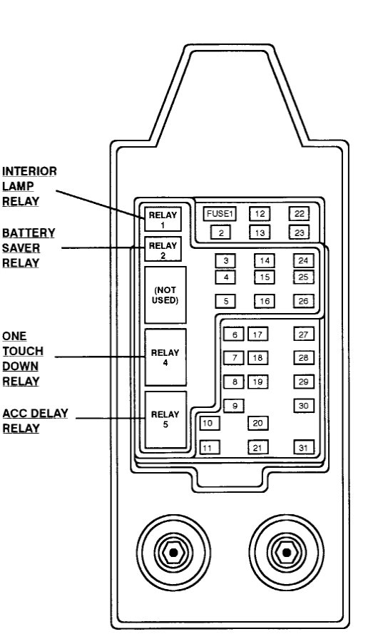

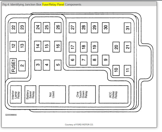

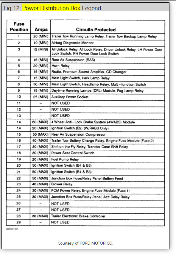

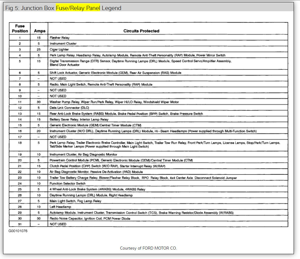

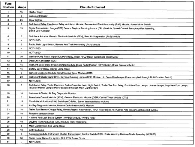

Here is a guide and a full fuse panel location and identification so you can run some tests. Check fuse #20 5 amp.

PACO8224
  • 117 POSTS
The first one is under the dash, and the second one is located under the hood

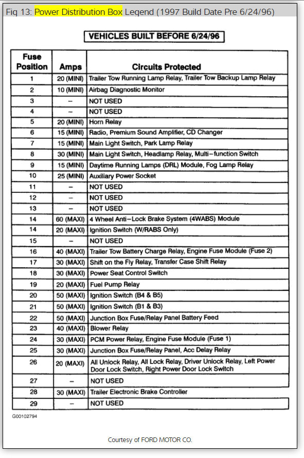

I looked at 4.2l engine early production wiring. My wiring doesn't say pcm fuse, it just gives a number and amp rating. If it is the fuse I'm thinking about, like hunting a needle in a haystack. That fuse supplies many different circuits.
Just a thought, try pulling the fuel pump relay and see if still blows the fuse. That may not be conclusive?
Feb 12, 2019 at 2:06 AM (Merged)
JDL
  • 16,098 POSTS
I just rechecked the wiring, I don't believe pulling the relay will help.
