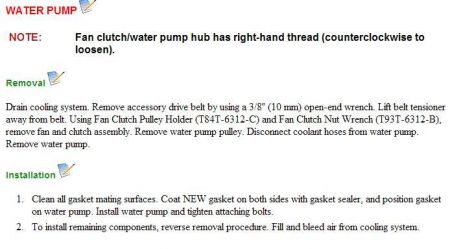

1996 Ford F150 6 cyl Two Wheel Drive Automatic
Hi, I need to replace the water pump on this truck but I cannot figure out how to get to the old one to remove it. I'd appreciate any help...

https://images.2carpros.com/forum/automotive_pictures/261618_Noname_1481.jpg

Very much! for the information. That would have worked had we been able to get a good set of those tools. The 2 sets available were both tweaked and unusable. It's going to the shop tomorrow... but I really appreciate the quick answer!
