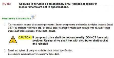

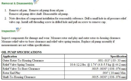

what is the procedure for replacing an oil pump in the 1996 ford f-150 with a 5.0L?
