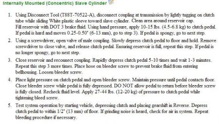

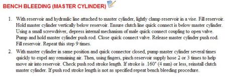

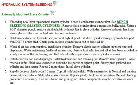

The clutch cylinder/ slave cylinder broke and i replaced it. after hooking up the line beck to it there is no pressure behind the pedal. i know i need to bleed the clutch but dint know where to start
