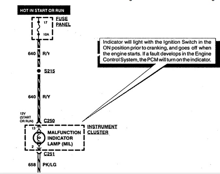

JDL
  • 16,098 POSTS
Notice the diagram, check the fuse. Check voltage and ground. The circuit is grounded by the pcm. Voltage comes from the fuse. Could be problem with wiring circuit? The bulb could be burned out or vibrated loose.

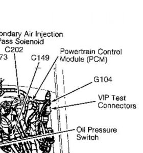

DALE32003
Computer problem
1995 Ford F150 6 cyl Four Wheel Drive Manual
where is the plug to plug the code reader in to my 95 ford f150
Sep 10, 2020 at 3:04 AM (Merged)
  • 75,992 POSTS
In left rear of engine compartment,on bracket. It is the VIP Test Connectors.
