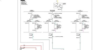

1994 Ford F150 6 cyl Two Wheel Drive Manual
Im looking for someone that might have a diagram for the starter cylinoid to the starter wiring hook up diagram,with pics
Jan 28, 2010 at 4:13 AM
  • 75,992 POSTS
At the starter relay you will have a battery cable at one end at it that goes to the starter and a small red wire that goes to the starter-see below starting system EWD
