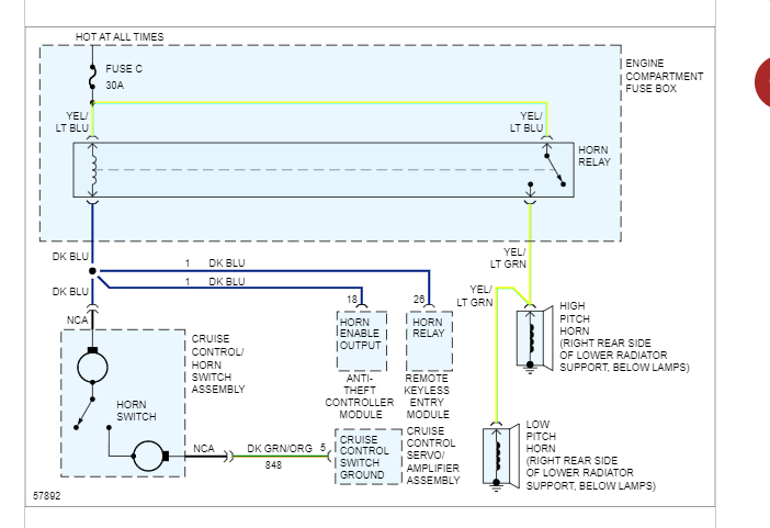

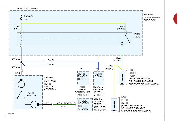

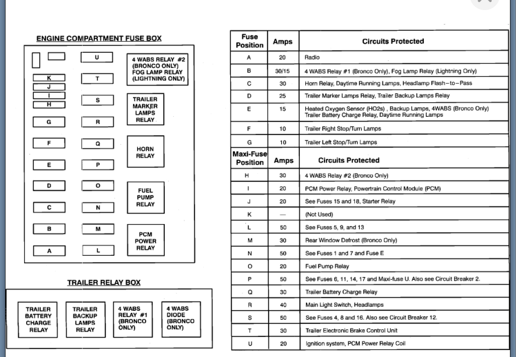

is there a picture showing where the horn relay is located?
May 17, 2009 at 1:33 PM
Experienced Mechanic
18,907 POSTS
The horn relay is located in the engine compartment fuse box, so we need to use the info below to locate this.
Here are a couple guides that will help with testing this relay if needed:
Please see below and let us know if you need more info.
