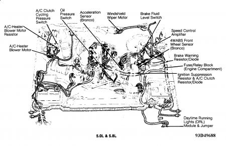

Where and what does the blower motor resistor look like in my 1993 f-150
Thursday, March 11th, 2010 AT 11:13 AM
BLUELIGHTNIN6
MECHANIC
16,542 POSTS
Hello and thanks for donating
the blower motor resistor is on the right side of the firewall, near the A/C-Heater blower motor.
