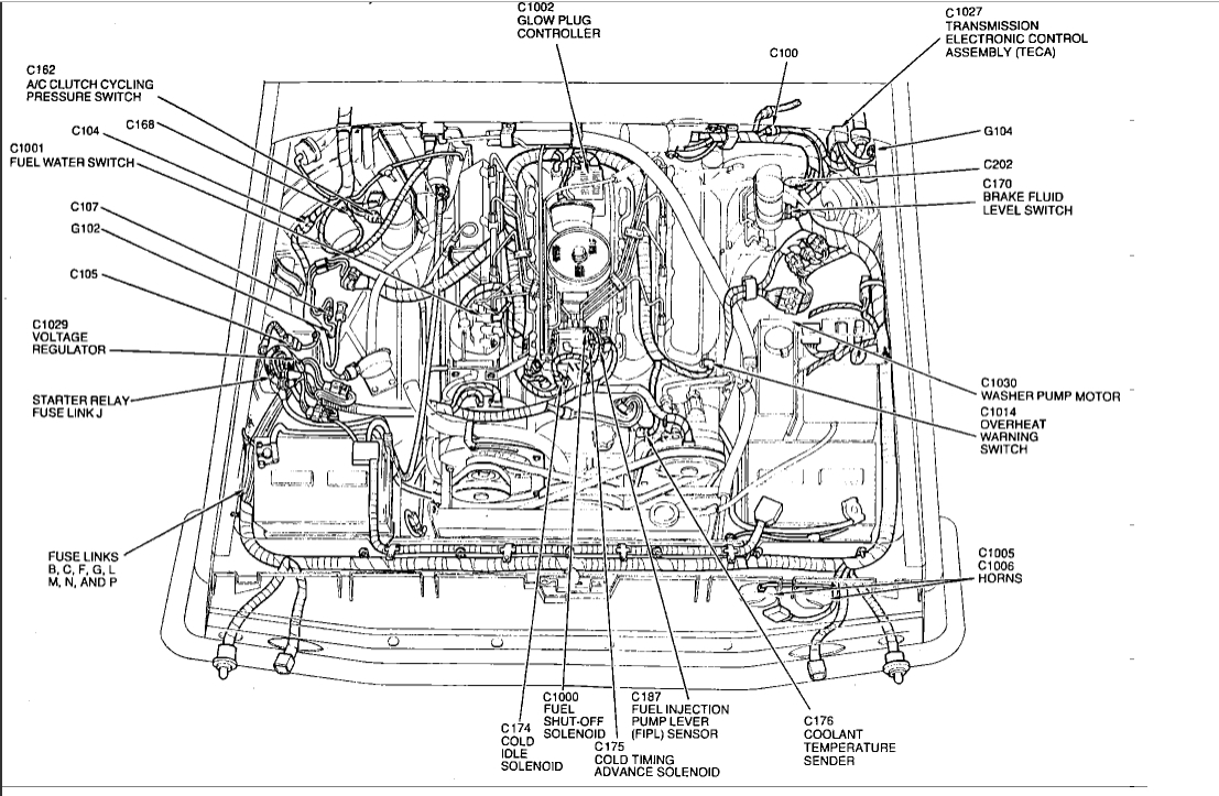

where do I find the voltage regulator on the 1992 Ford F150 xlt 8 cylinder

The voltage regulator is located under the hood and the passenger side, front side of shock tower, mounted on fender well.
