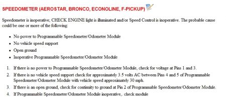

Every thing on the cluster works fine except the speedo & odometer. The speedo needle never moves & nothing comes up on the odometer. I think it has to be a problem with the power wire or it is not getting a signal from the speed sensor. I need to know what wires go to what behind the cluster.

https://images.2carpros.com/forum/automotive_pictures/261618_Noname_2045.jpg
