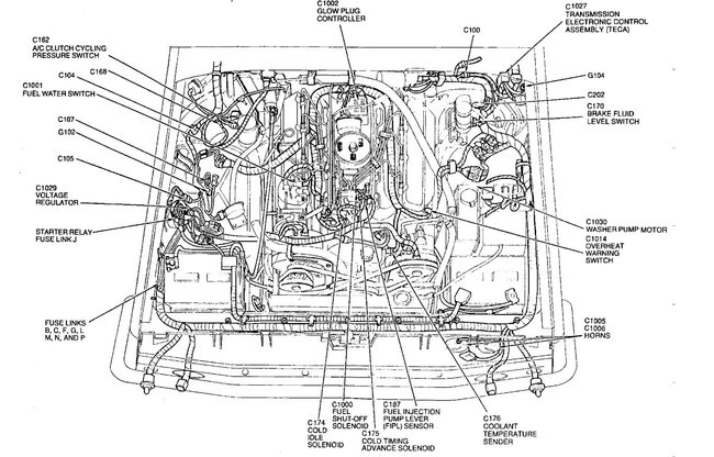

what does a fusible link look like and where is it located
1991 FORD F-150
VERBAL2009
Apr 14, 2009 at 4:18 PM
  • 75,992 POSTS
Those should be coming off the starter solenoid, there will be several of them attached to one of the large posts on the solenoid. The starter solenoid will be mounted on the inner fender near the battery
This guide will help you teat them
See the diagram below for locations
