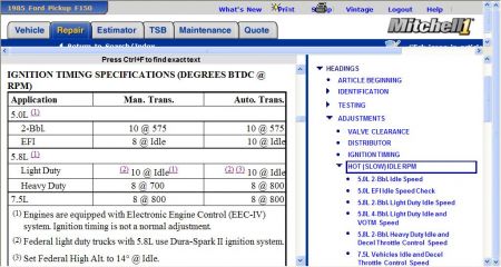

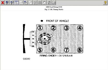

My problem is I need to know how to time my truck by the distributor and what the fireing order is any advise is helpful thank you

See below
