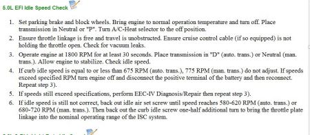

My truck stall at stops and when it idles it surges like crazy, example ill be driving and ill be coasting and it wil start to studder and it sounds like something is jamming. And when im sitting at a stop itll jus surge and turn off and if I press on the gas itll start starting and stoping.
help please ive spent alot of money and havent had a good idea what it could be. Help!
thank you--- mike

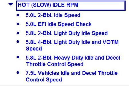

Hi there,
Thank you for the donation,
Now which is your engine.....
http://www.2carpros.com/forum/automotive_pictures/61395_Capture_2.jpg

Its a 5.0L efi

Idle re set procedure, also check for any induction vacuum leaks, start here.
http://www.2carpros.com/forum/automotive_pictures/61395_Capture_4.jpg
mark (mhpautos)
Wednesday, May 26th, 2010 AT 4:39 PM
MROB10
Well I checked the vacuum leaks, it looks like there fine and it was running good for a couple day, but today it kinda did the same thing but it sounded like it stalled but then when I hit the gas it came back on and then hesitated till I pull over
