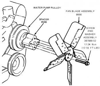

can't get the fan off the water pump everyone says it screws off can't get it off
